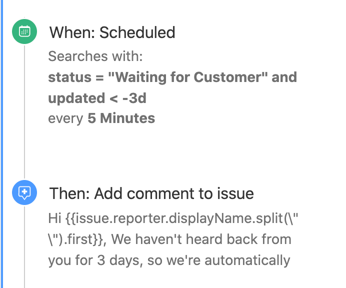

In the screenshots you can see the trigger and what should happen. When I validate the JQL I can see the tickets, but when I run the automation nothing happen.
I want that the comment will add in the ticket and so it reminds the reporter for doing something.
Second automation should close the ticket after +7 days, but also this is not working.

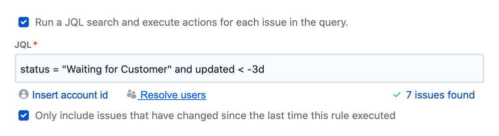

What happens if you uncheck the "Only include issues that have changed..." box? It seems to me likely that none of the 7 issues that were found by the JQL have been updated since the rule was last run.
salihzett
June 2, 2020
Works, thanks. But weird, I thought if this found the issues, it is fine. But got it now.
