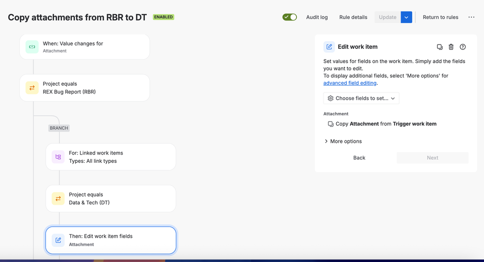

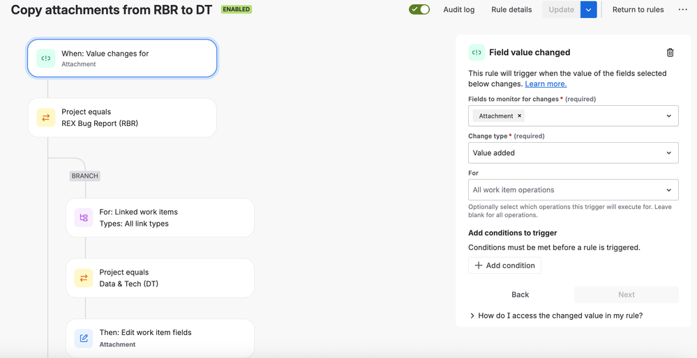

I created another set of rules to copy attachments whenever they are created, from any one linked project to the other. There are 2 rules and the one that copies from RBR to DT looks like this:

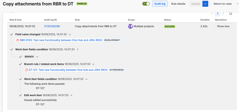

The audit logs show no errors, however, the attachments are NOT transferred along.

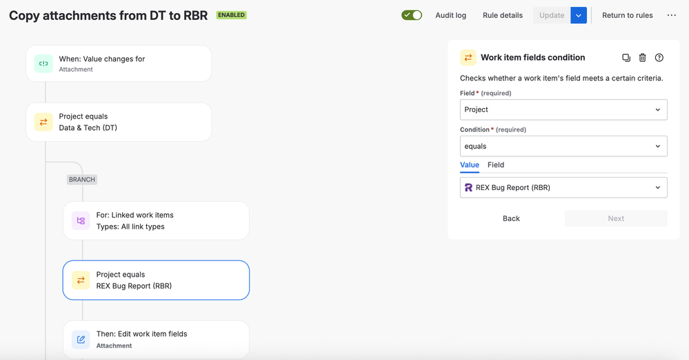

The other rule, from DT to RBR, shows in the audit logs that no action has been performed because the linked "work items do not meet the condition".Screenshot 2025-08-19 at 14.24.00.png

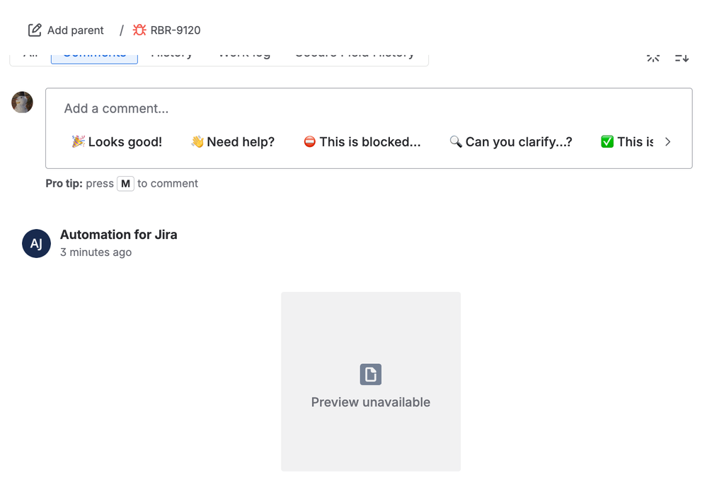

However, because in Jira Service Management the attachments get automatically transformed into a comment, the comments do get transferred successfully as subject of a previous automation :).
Still, these comments show as "preview unavailable" in the linked project, as below:

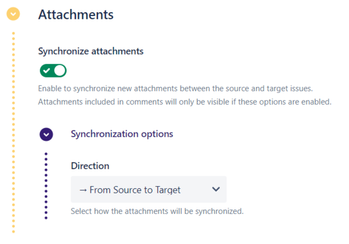

As an alternative to Automation that can be really complex to implement sometimes for specific use cases, I can suggest trying our app Elements Copy & Sync.
You'll be able to synchronize comments and attachments between linked issues (cross-projects and even cross-instances).
Don't hesitate to check the documentation, it’s really quick and easy to set up.
The app is for free during 30 days (and it stays free under 10 users).

Alright, @Marc -Devoteam- , I figured out what was wrong.
In the Copy Attachment action I selected "current work item" instead of "trigger work item".
So the automation should look like this:Screenshot 2025-08-19 at 16.03.33.png
That still leaves the photos attached within comments who do not get transferred along properly and show "preview unavailable".

Photos in comments are attachments an link to an attachment in the issue. If you paste a photo in a comment its linked to that issue. So when copying components the preview wants to use the key of the issue where it was pasted, but on a new issue this key is different.
So its best to add attachments direct and not via a comment.
