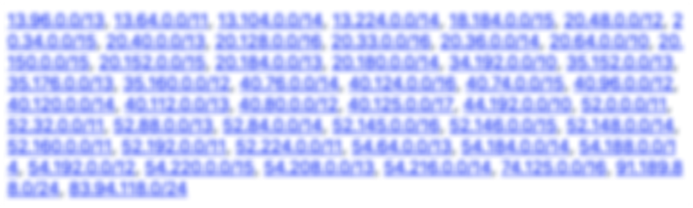

For the marketplace issue, one customer has been looking into the traffic from JIRA outwards, and states ( not my words).. :
"It seem that Jira reaches out for many things and its not possible to limit it tot the Azure, aws, confluence,..... ip adresses that are targets..
Last tested FW rule that was insuficcient was "allow for":
Screenshot 2020-05-06 at 07.55.26.pngeg. a lot of different IPs ...
So now there is open for "any"..."
Quote end.
That was his findings, and I think that the problem is that firewalls normally does not do "domain based" firewalling, but is on IP level.
