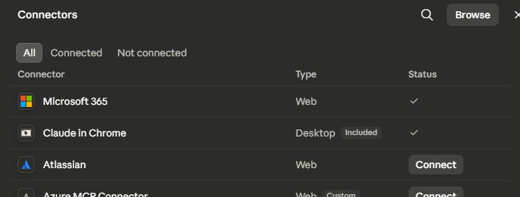

Richard Baysa
July 15, 2026
Maksym - the problem I have is on Claude I can only use the "connect" or browse connectors.   I can't add a URL then connect to it.
