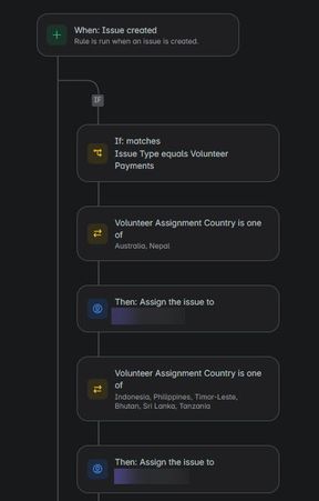

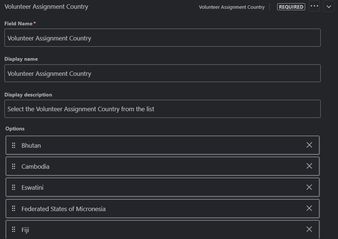

I have to create an Automation Rule to assign the request to specific user based on the Country selected from the dropdown custom field.
I am using the logical operator of 'one of' and then selecting the Countries from the available value to build automation.
I created the Automation using IF condition. When I created a Test request and selected a specific Country, the request stays un assigned.
screenshot of the field from request type
screenshot of rule (partial to give an idea)
Please let me know how can I make this work?
Thank you

Without first seeing the rule's audit log details, I see two things to correct in your rule:
(1) The Issue Created trigger can start a rule so quickly that some data may not be ready for the rule to use.  To fix this, please add the Re-fetch Issue action immediately after the trigger.  This will slow the rule slightly and reload the data before proceeding.
(2) Your rule is using an if / else condition block but has all the conditions bundled in one area.  Instead you want separate if and else / if sections, as shown in the documentation.
With this changes, your rule would look like this.  Please adjust based on your actual conditions required.
  • trigger: Issue Created
  • action: Re-fetch Issue
  • condition: Issue Type equals Volunteer Payments
  • if / else block
    • if
      • condition: Volunteer Assignment Country is one of Australia or Nepal
      • action: assign the issue
    • else if
      • condition: Volunteer Assignment Country is one of Indonesia, ...
    • ...more else if sections for other cases
