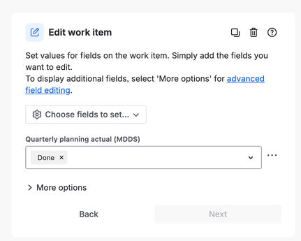

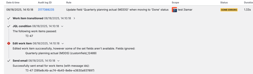

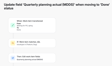

Hi, I'm trying to set up Global automation, but I'm having trouble. I have a transaction from Qaing/Waiting for PO --> Done. I want it so that when this transaction occurs, a field in the ticket will be updated: 'quarterly planning actual' should match Done. My issue is that the Done status is set as non-editable in its properties. Is there a way to bypass this? Or do it differently? If so, I would appreciate guidance because I haven't found a solution.

@amit_bakst  Could you confirm, that the fild that you are editing on the Done, is that availble on the Edit issue operation? also, what is the properties that you have applied, can you please share me that snap?

I can confirm that the field we are trying to edit on the Done is available on the Edit issue operation.

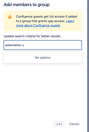

Hi @Yogesh Mude ,
How do I identify this user? Is this something I need to create? (automation user)

August 20, 2025
@amit_bakst Sorry, i tested with projectrole = atlassian-addons-project-access and even tho the automation for jira user is from the add-ons still workflow property will not allow you to edit the field.
Thanks for the checking, thought that it will work but it does not.
