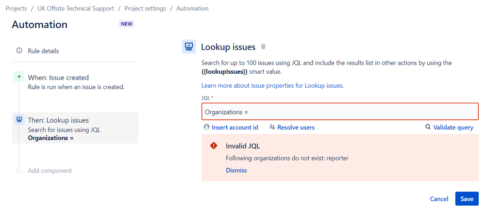

I know the way to do this is to run a JQL Look up automation, but I'm not sure what the JQL will look like. So far, I've got this:
Any ideas on what JQL statement I can use to find a reporter's organization?

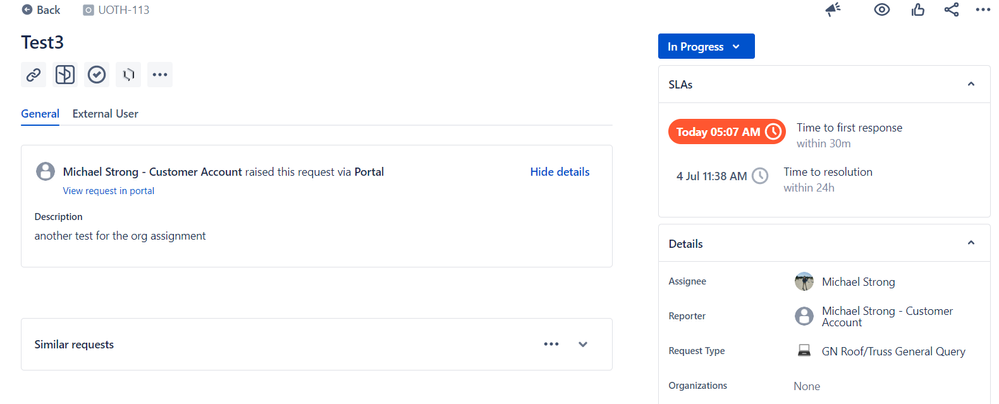

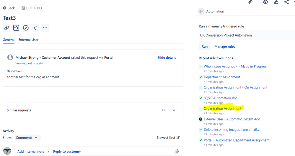

To break down the issue bit by bit, I've already created the automation you outlined before, as follows:

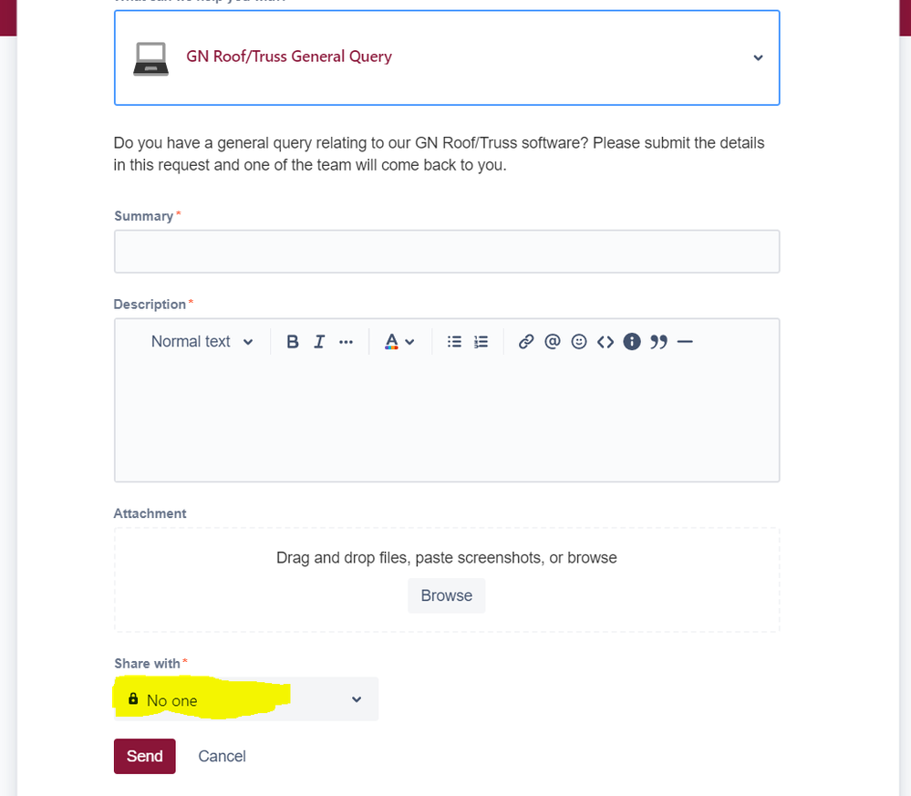

But when I create a new issue from the portal, despite the issue successfully passing through the automation, it doesn't assign the issue to the organization. The organization below should be "ITW Construction Products", as that's the organization that it's apart of.
The only way the issue gets assigned to the proper organization, is if the customer chooses to share the issue with their organization.
So in my mind, either I'm missing something in terms of the Organization field, or in terms of the forms that I'm getting people to sign. Maybe there's a way to change the default value to the "Share with" option to "share with organization", and have it hidden?

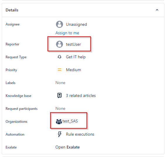

Is the reporter´s user already member of an organization? What kind of domain is it that you tested with? --> the rule won´t work for free mail-providers like gmail, etc.
I tested this kind of rule on my side and it worked:
testUser has an email with a private domain and is a customer in the organization "test_SAS". I created the request via customer portal setting the setting to "share with no one". After the creation the organization was set automatically --> see screenshot
BTW: yes there is a way to set this option to default:
click the cog at the upper right corner --> Products --> Jira Service Management --> Configuration
You´ll see the following option:

Hi @Michael Strong and welcome to the community,
First of all: I‘m mainly dealing with Jora Software but as far as my knowledge reaches I doubt that a JQL could solve this/deliver what you expect.
the result of JQL will be a list of issues regarding your search parsmeters. As far as I know organizations are not „issues“ as such (like requests or incidents).
I could imagine that this might be possible to solve with smart values (can‘t verify that at the moment). Otherwise I would try to gather that information via API.

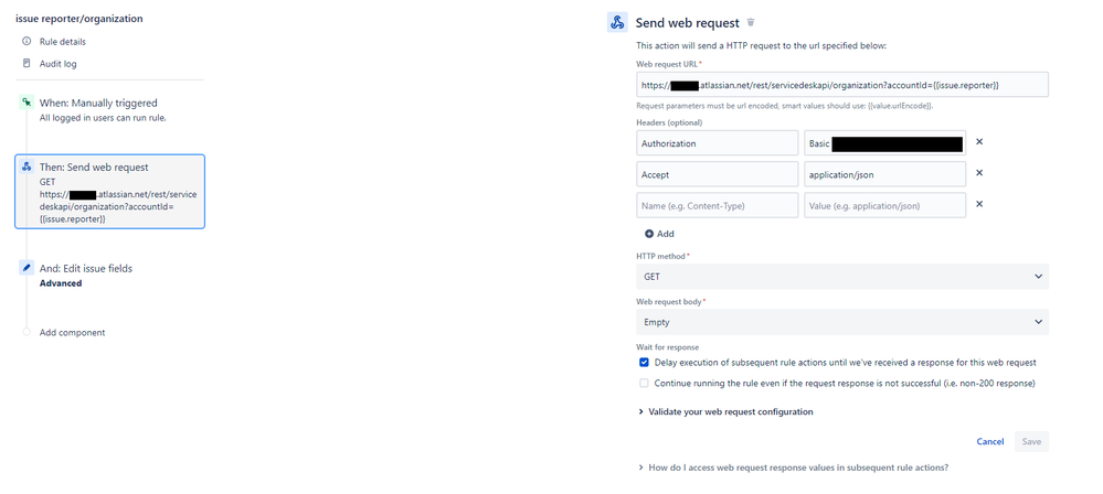

Maybe this could be a starting point for the api based solution:

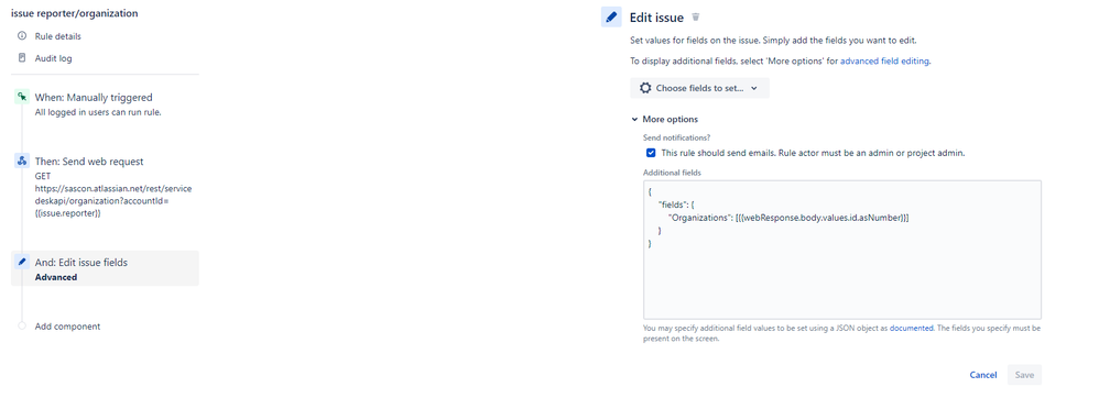

did you consider the solution via API? Following automation rule did (as far as I understood the requirement right) the expexted work:
Feel free to give it a shot and let us know if this helps.
Best
Stefan
Hi Stefan,
I had the same problem, your solution worked for us. Thanks!
