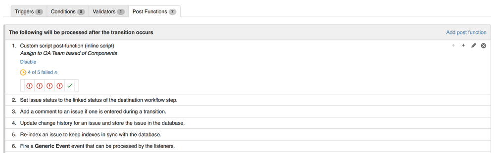

Now my requirements is while transition from Development to QA state in the workflow i wanted to add an post function to auto assign tickets to different QA - users based on component names, i have tried using script runner Add-on and added an post function - custom script

But now i get Null Pointer Exception Error: any suggestions please ??
2018-12-07 00:26:30,186 ERROR [workflow.ScriptWorkflowFunction]: ************************************************************************************* 2018-12-07 00:26:30,188 ERROR [workflow.ScriptWorkflowFunction]: Script function failed on issue: DEMO-106, actionId: 61, file: <inline script> java.lang.NullPointerException at com.atlassian.jira.issue.IssueImpl.getCustomFieldValue(IssueImpl.java:896) at com.atlassian.jira.issue.Issue$getCustomFieldValue$3.call(Unknown Source) at Script814.run(Script814.groovy:26)

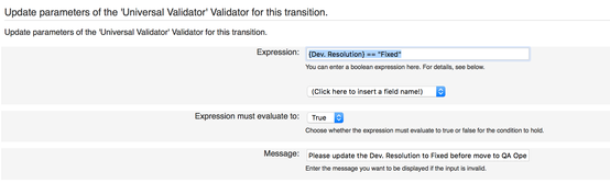

The final solution which worked for me - this may help someone
I had the Created Validator added - "Universal Validator" which check for my custom field Dev.Resolution value if "Fixed" the transition to QA
To auto assign issue to QA - members based on component names - i had added the post function script using script runner - "Custom Script"
