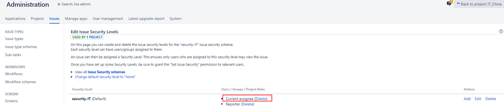

In the project, I configured the issue security  and added the current Assignee to the security level.
When he finishes deal with the issue, he cannot see the issue again, how could I do to let the assignee can see all issues he has processed ,but not other issues?

yundong.li
September 5, 2021
Hi  Anvesh Kagithala , thanks for your help.
I am the jira administrator , I can add issue security level.
I set it like this pic:
but after the current assignee deal with the issue , he can not see this issue again.
how could I  do to  let he can see the issues that he deal with ?

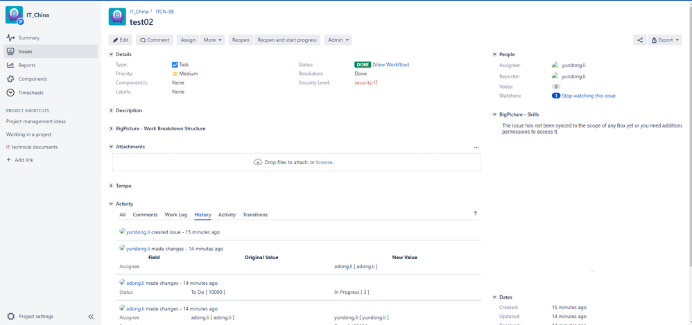

hi Kagithala, is it this screenshot ?
yundong.li create the issue and assign to adong.li;
after adong.li deal with this issue ,he can not see this issue again.

KAGITHALA BABU ANVESH
September 5, 2021
As per the security level. the issue is viewable by only , Reporter and assignee.
For other it will not visible. if you want to see it, please update the security level by adding yourself.
