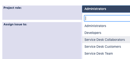

Just to go through the same steps. I clicked the transition in my workflow, went to post functions, added a post function, selected Assign to Project Role, clicked Add. Then the top option was the project roles with in my project.
From there you can choose how the assignment is done from the role. such as next, previous, least busy, round robin in a group.
Are you getting different options? Or did you maybe select a different JWT post function?

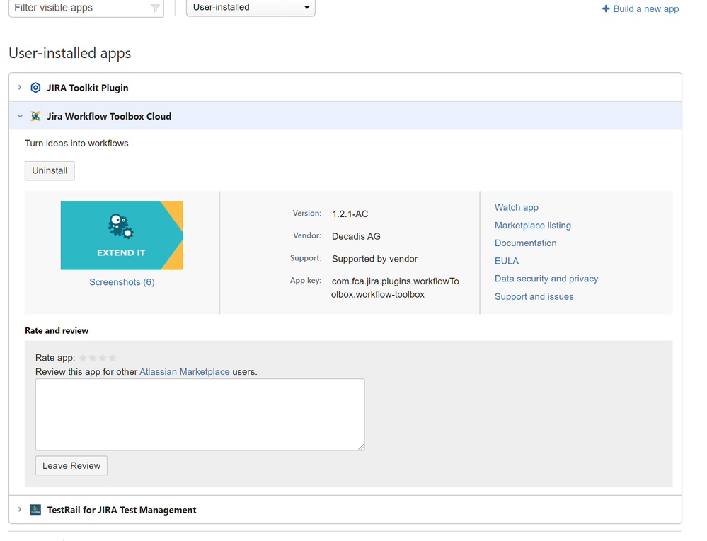

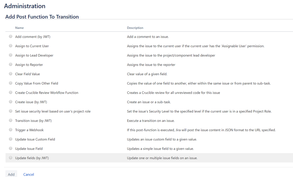

Chris Whisenhunt
February 6, 2020
Hi Nich,
By following the steps you provided I get a different set of options.
Perhaps I installed the wrong toolkit?

Oh cloud, might have different admin abilities in the platforms. I tested on server.
Chris Whisenhunt
February 6, 2020
Good to know I'm not crazy. Any chance you know where I could locate the differences or know of anyone that could help?
