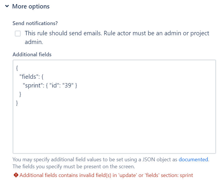

We have a situation with out system development-department where we want all cases in the backlog to be shown on the "Board" in status Todo. We will have multiple sprints active at the same time depending on how the feature will be developed. To show a newly created case on the board it has to be added to a sprint. We have therfor created a sprint we want to add all the new cases to(to work like a backlog but show up on the Board). There will be too many new cases to do this job manully, and we therfor want to use atomation for this. The trigger will be "issue created", and we wwant the result to ba that the issue is added to the named sprint. Since we will have multiple active sprint simultaneously so it is not possible to use the action "edit issue" and the "Sprint" filed on the issue, since here we only have the possibility to choose the active or the next sprint(since we have multiple sprint active and will create new sprint later). I therefore think the solution will be to find the Smart value where the sprint data is stored, and updated this, but i find it hard to find the correct field and how to update it with the JSON. I have tried to find the value fith the sprint-data using the REST APIs, but it seems like the keys and fields in the API is different regards to the sprint-info on different issues, even though both issuestypes have the sprint fiield. Can someone assiste me in how i should do this in Jira Cloud?

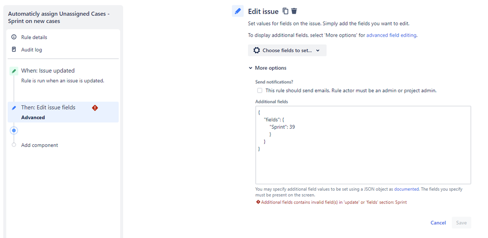

Hi, thank you so much @Trudy Claspill . It seems like he wants to do the same i want, but unfortuntly it seems like it does not work for me. I get the id of the sprint i want to assigne it to(39), but when i do the last part in the action, i get "Additional fields contains invalid field(s) in 'update' or 'fields' section: SprintSkjermbilde 2023-06-02 182419.png

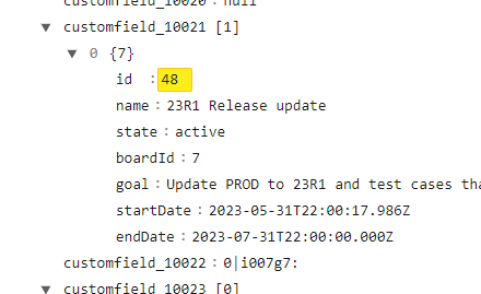

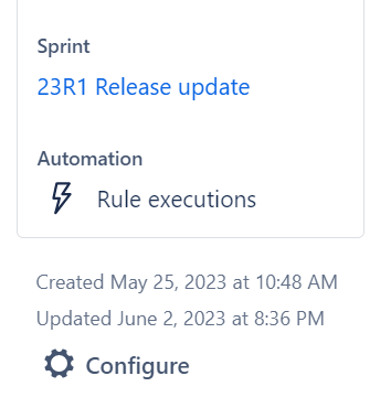

If i use the REST API on the issue, i dont see the "Sprint" as a vlaue there, so this makes sense i think. But i see that i have the info about the sprint the issue is assigned to in this field:
48 is the ID of the sprint its assigned to now. Im not sure if this is just info of if changing this has any impact on which sprint its in. But when i try to change this i get an error:

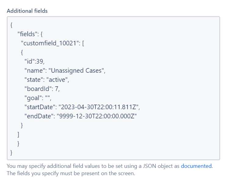

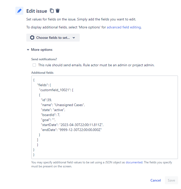

I try to change it like this:
(Have tried with one less } at the end also)
Do you have any idea what i do wrong?

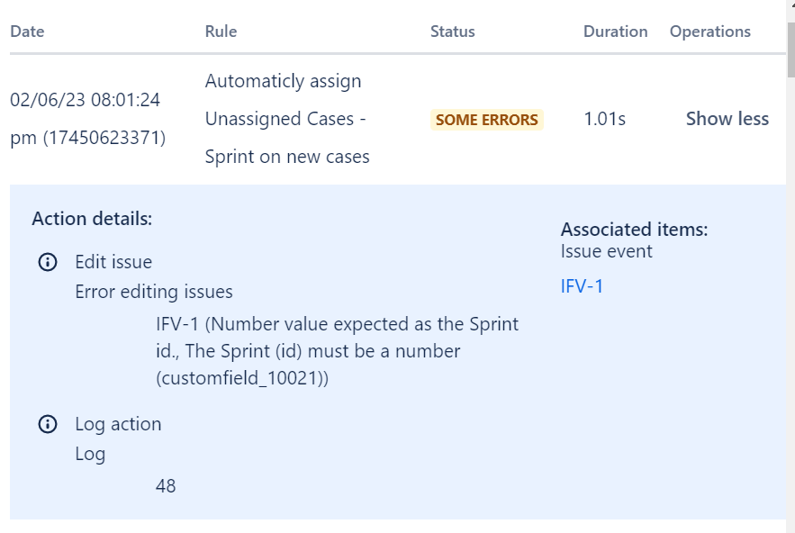

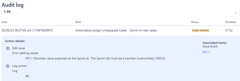

Here are them after removing one bracket. Thank you

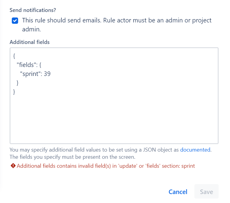

When i try i gte the error that Sprint-field do not exist. Any idea what is the reason behind this?

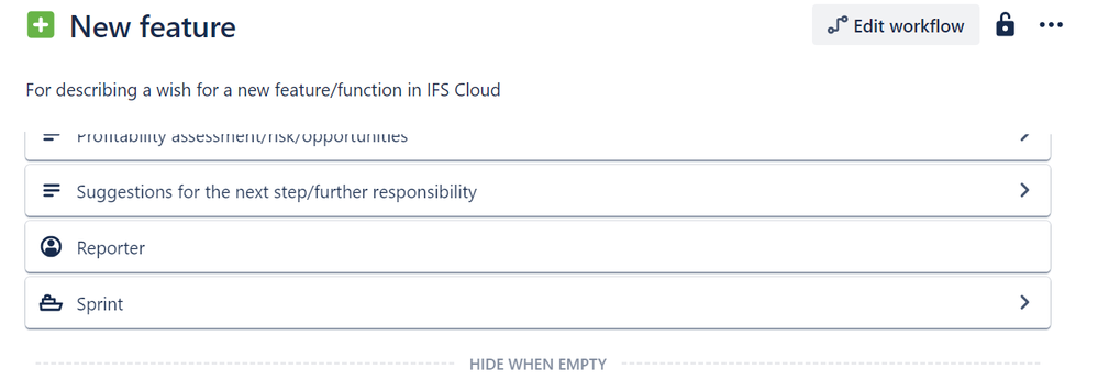

The sprint field is on the issue type, and as you can se above it is filled out

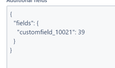

But when i changed the name to the custom field IT WORKED!!
If works now, and im so greatfull! Thank you so much for your help and that you took your time to help me!
For anyone else having this issue:
Use https://XX.atlassian.net/rest/api/2/issue/XXX-XX (XX is the jira area and XXX-XX is the issue id)
Here you have all the info you need about the issue. Search for the sprint name or the sprint id.
Find the sprint id you want toassign it to, and use this as in my example above.
Like # people like this
