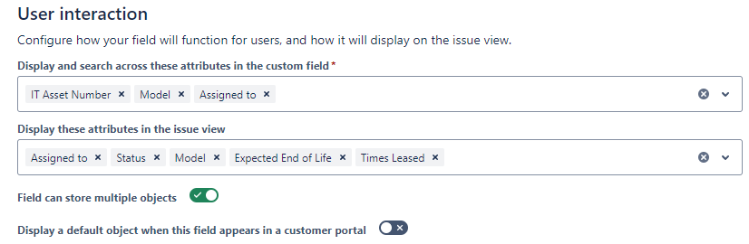

Do the reporters have JSM licenses and access to Assets?
Otherwise I believe it should be enough to let the user pick their own asset directly, and only decide what can be seen in the portal view via the context values
The first field decides what can be searched and seen within the portal view
And the second field decides what is visible to agents from within the issue view
So in my case below, users can search for their IT hardware by either the IT asset tag, the model of the device or by searching their own name.
The selected devices will then be displayed inside the issue to agents with the information: Who it's assigned to, the status of the device, the model, when we believe it has reached end of life and how many times the device has been previously leased to other people.
Have you tried doing it like this? And in case you have and it didn't work, what was the issue?

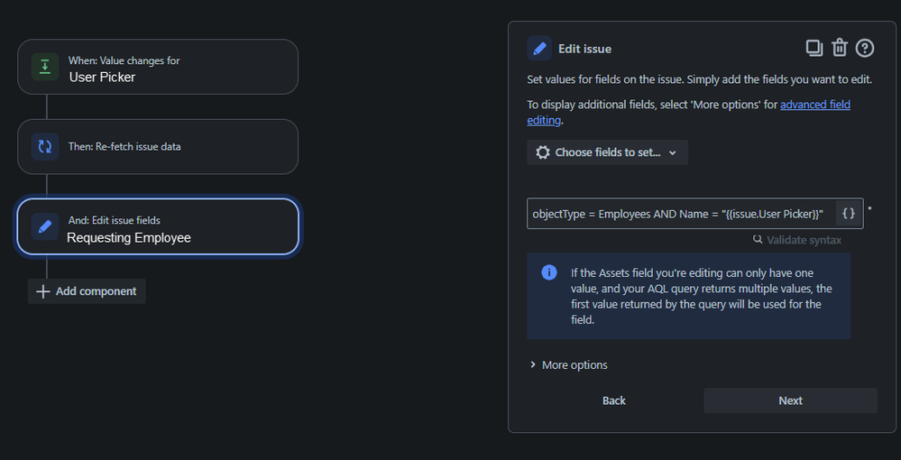

Robert Hook
October 29, 2024
@Ashley Honeycutt
So as an example, you have an Assets object type called Employees. And the Employees objects have attributes you want to display in an issue field called Requesting Employee, which is an Assets object field.

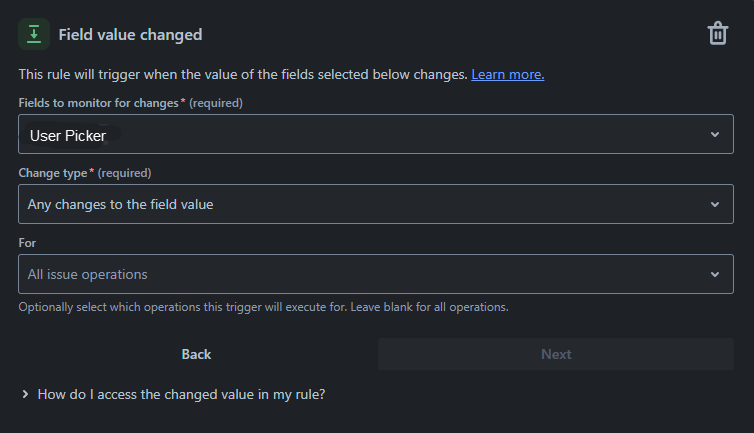

You could use a Trigger for your automation for Field value changed, then select the User Picker field, and either "Any changes to the field value" or "Value added" as the change type. This should kick off the automation when something is added or updated in the User Picker field.
(Side note: I often find I need to insert a Re-fetch issue data step after the Field value changed trigger for it to work properly.)
Next, you would have an Edit issue step in your automation. Select the Requesting Employee Assets object field in the dropdown list and update it with an AQL to match the User Picker field. Something like:
objectType = Employees AND Name = "{{issue.User Picker}}"
In that AQL, the assumption is that your Employees objects have a Name attribute that you can use to match with in your query.
You can also do this with a Lookup objects step in the automation followed by an Edit issue step that updates the Requesting Employee field with {{lookupObjects}} , but that seems like overkill when you should be able to accomplish it in one step.
The above example AQL may not work for you and may have to be tweaked depending on how you have your Employees asset object types set up and what the attribute types are for the Employees objects. It is difficult to write a proper AQL without having that information.
