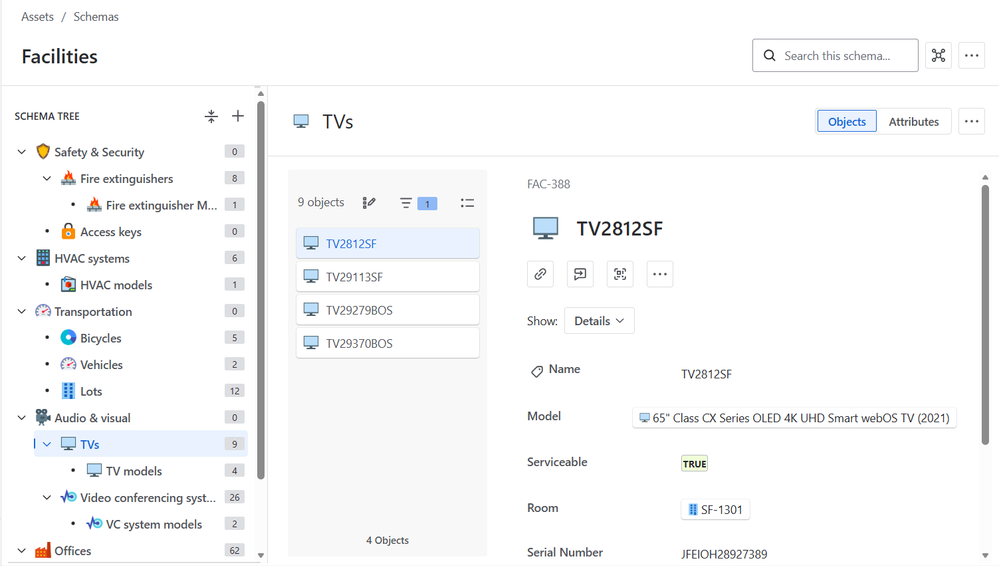

We have an inventory set up in Jira Assets which is working nicely.
The requirement is just to have an asset table on confluence that only shows items where the Current Stock Level is a lower value to the Restock Level.
Both attributes are set up as Float as we require decimal values.
Thanks

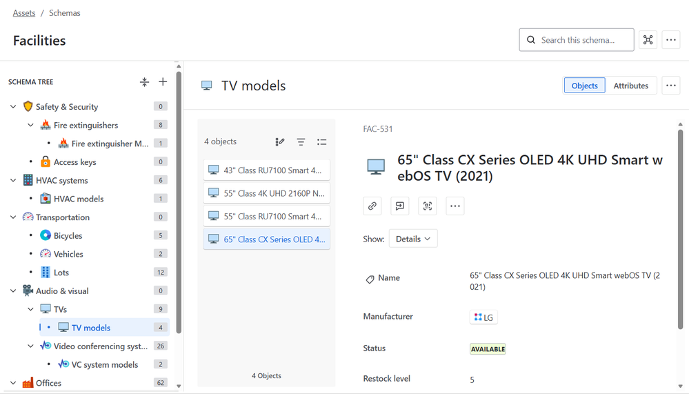

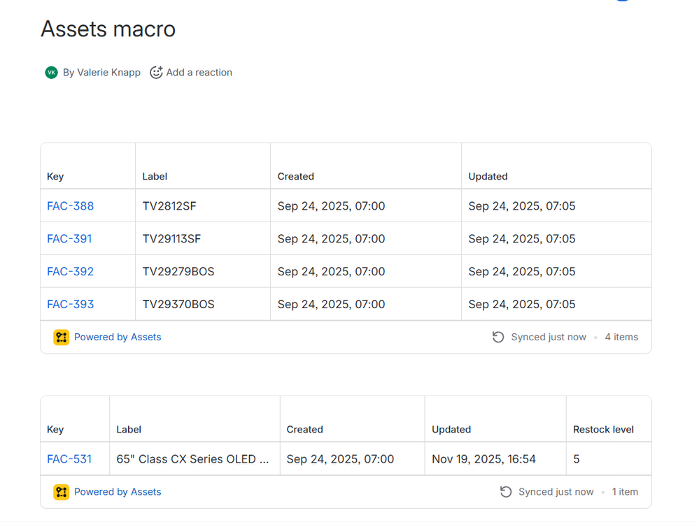

On @Marc -Devoteam- 's suggestion, I tried to get something to work using the Assets macro in Confluence but I don't see how you can do the confrontation between the results of these two macros:
Where the first table is the representation of this folder of TV objects, filtered by the TV model:
And the second macro is the object of TV model, with the restock figure
This is why I suggested Confluence databases because to be able to count the rows in the Confluence Assets macro and then compare this number with the restrock number, which is an attribute of another Asset in the other macro.... seems a bit too much for Confluence in this moment.
