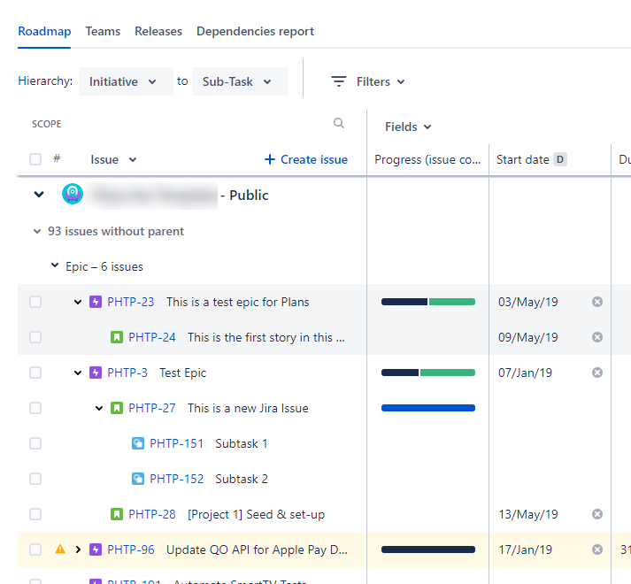

One option, if you have Premium, is using the Plans (advanced roadmaps) feature. It does a lot more than just allow a hierarchical view, but if that's all you need you can use it that way.

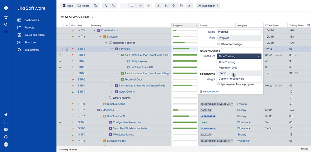

Another option is a plugin like Structure. It allows you to configure multiple levels of hierarchy (including levels above Epic if necessary.)

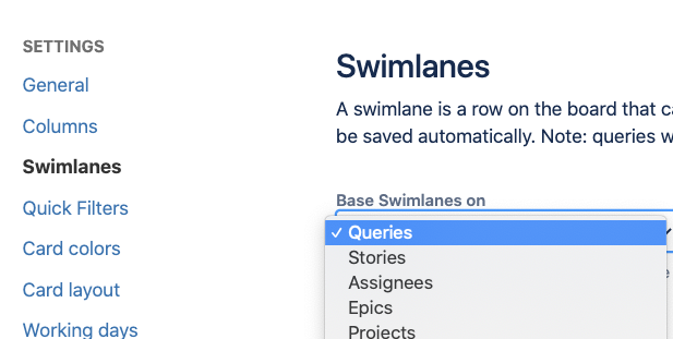

Within the board settings, you have the option to choose Stories or Epics for what to base the Swimlanes on. To the best of my knowledge, there is no way to do both at the same time with the existing functionality.
You can, however, build custom queries for Swimlanes. So if you can build a filter to encompass everything you want, you could in theory have them display together that way. So you could do everything with a parent ticket in a specific epic (either display just subtasks which will have some amount of story signifier on them, or display both stories and subtasks)
