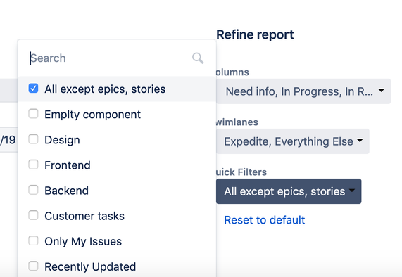

I've found the way to except Epics and Stories from the calculation in Control Chart.
For doing it you need to:
1. Create a new quick-filter on the board settings:
project = PROJECT_NAME AND issuetype in (Bug, Improvement, Issue, Sub-task, Task)
2. Select created filter in Control Chart:
