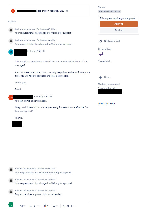

No, i've just checked the screenshot from the user and there is no "Show details" button for them

Asher Francis
October 2, 2020

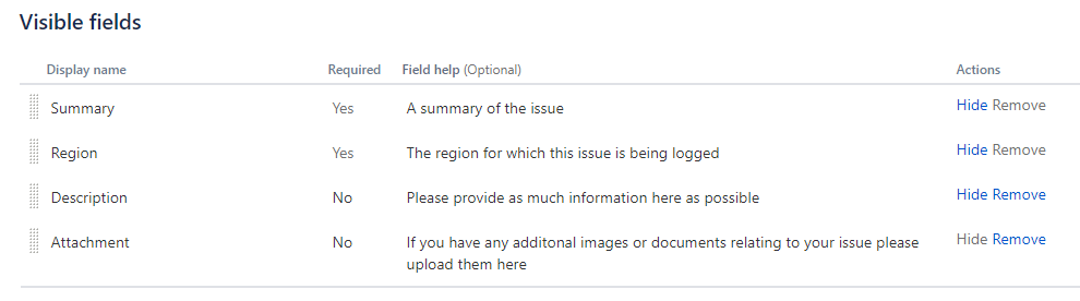

I've checked and the field is there and visible. Still doesn't appear for approvers!
image_2020-10-06_103759.pngThanks
Asher

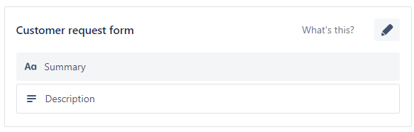

If you look at the 'Agent view' tab on the request type settings, does it show the description in the customer request form as below?
image.pngThanks, Liam

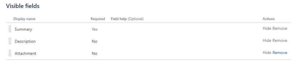

When you set up email requests, you have to choose a "Request type" for emails. I have created a specific request type with just Summary, Description and Attachment fields for issues that arrive via email which looks like this:

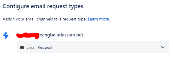

I have set this request type up for my email requests as follows:

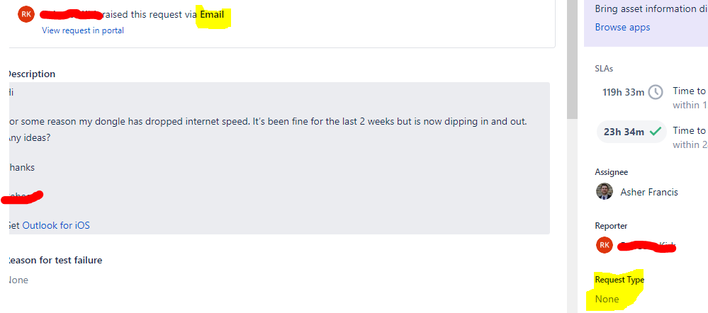

However, issues that have been created via email do not have a request type.
Why would this be, when the above is set? The "Email Request" request type is hidden from the portal
If I manually set the request type, I then get the "Details" button in the Customer Portal!

So, I figured this one out
When our emails come in they are created using the "Email request" issue type, but this only has Summary, Description and Attachment fields, since I can't use my other issue types as they have mandatory fields and can't be used for email requests.
I have an automation set up that checks when an issue is created, and if it's an Email Request Issue Type (linked to the request type), then immediately change the Issue Type to Incident. This is so it picks up the extra required fields such as category, region etc required to be filled in
However, it turns out that changing the Issue Type removes the Request Type - so every time an email is received, the rule runs and essentially removes the request type. No request type = no customer form!
I've now created extra automations which re-apply the request type when the issue is transitioned, based on the issue type. IE When Issue is Transitioned, if Issue Type = Request then set Request Type to Request. Since all our issues come in get triaged from a global unassigned queue, this works for us.
