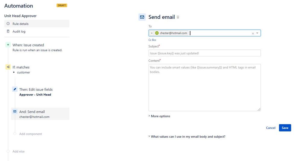

3. What I am trying to established, is that the unit director (Alice) shall receive an email as a watcher. (Currently in 'trial and error' mode).
Any advise Dirk?
Thanks
Hi @CHESTER RAMOS ,
Great! Good to hear you're making progress :)
What exactly now isn't working for you? The Head is being added as an approver and gets the email based on the customer notification ( so far so good)
Now you also want to add a 2nd person to keep in the loop I guess? You could indeed do that by adding them as watcher (there is a specific "manage watchers" action)
The thing with watchers tho is that they will only get notified for subsequent changes.
Also you'll have to see if they need to be a watcher or a request participant (that is an intenral user vs a customer that it is shared with)
If it is just a one off email to also include them then you'll be good with the "Send email" action imo..

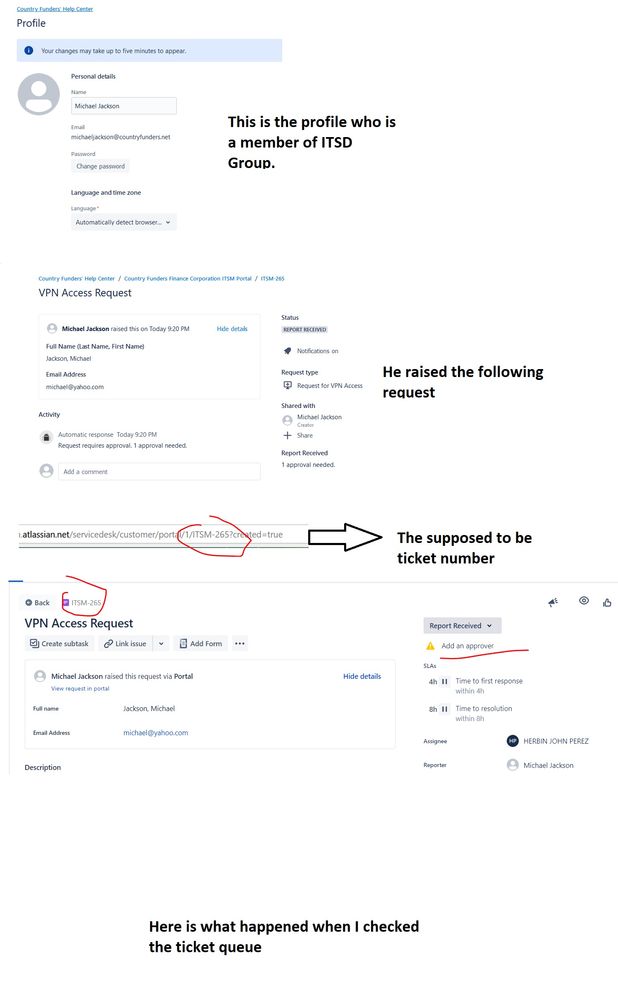

1. Logged in using another browser (Firefox) as "Michael Jackson"
2. Raised "VPN Access Request"
3. Given ITSM-265.
4. Checked the ticket queue , but ended up without the supposed automatic selected approver, I needed to select an approver :(
Now, I am stuck..

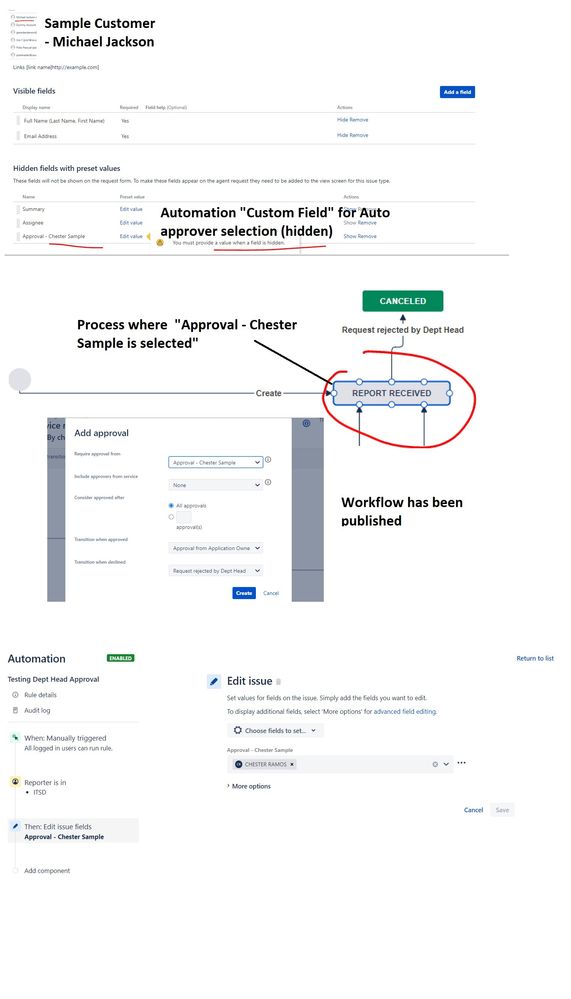

Tried this..
1. A Customer in the organization called "ITSD"
2. Left Chester Sample (User Picker (multiple users)" which is supposed to be the head of department first approver empty.
3. Screen cap shows "Approval - Chester" in the work flow. This is where the supposed auto approval will in the automation will trigger.
4. Last Screen capture is the automation that is enabled.

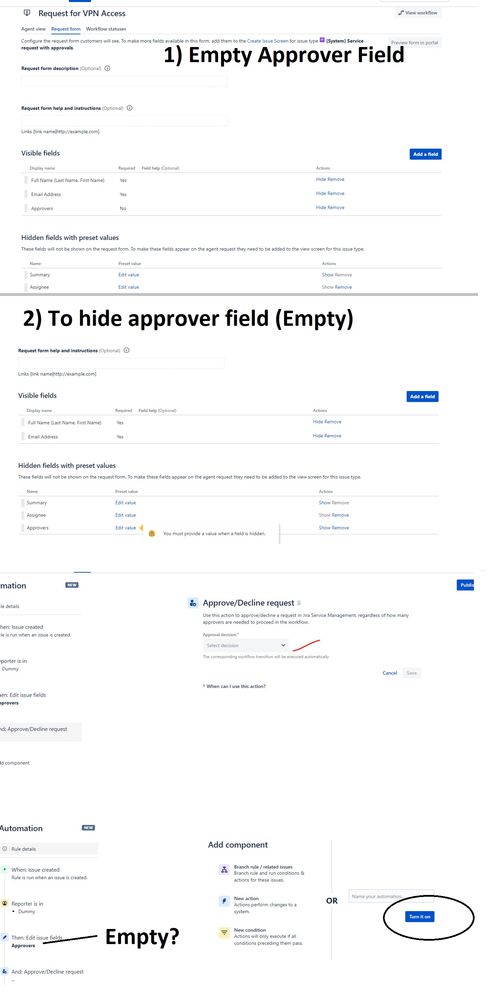

So I'd start by taking out that approval field on the request form.
Since it's empty it might mess up the value we set later and like I said, you don't need it if you're not gonna fill it on the form (or set a default value on the form)

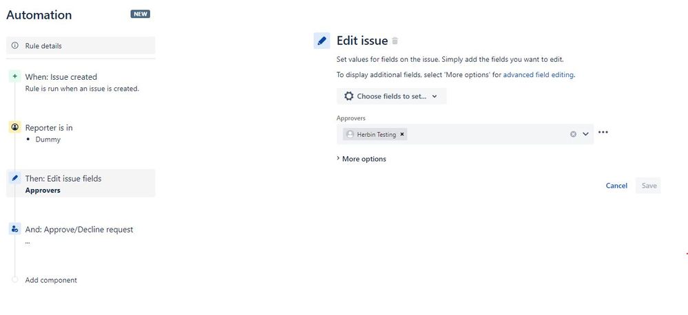

Hi, though it this does not make any sense,
I have managed to run-the-rule , but removed "And: Approve/Decline Request".
So that's already good :) We don't need that action!

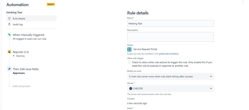

What I am trying to do is to create a rule with less coding.
Please refer the the screen cap below.
1. I am using "Request for VPN Access" to test this rule, which is one of JIRA default SRs.
1.1 "Approver" a JIRA default User Picker (multiple users) as hidden.
2. As you can see from the Rule, I have selected the user "Herbin Testing" as the approver
for the users in the organization called "Dummy"
3. Added "And: Approve/Decline Request". But did not select either auto "approve" or "decline" (Unsure if Herbin will receive any email notification)

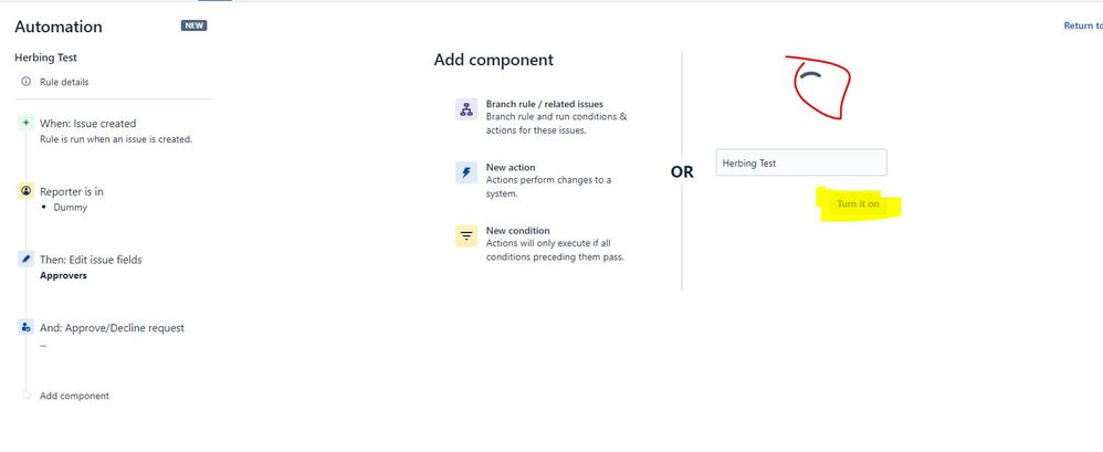

4. Turn on rule, but.. I am stuck in this "loading circle" for the last 15 min. (see screen cap below)--- Possible a JIRA issue, unless there is something wrong with this rule I create ("created a loop??"
Having said that for this testing
1. A new automation rule for individual organization
2. "User Picker (multiple users)" called approver will be utilized
3. Select different approvers (eg: head of department); varies per organization.
4. And use "Approve/Deny" request.
5. Run automation rule

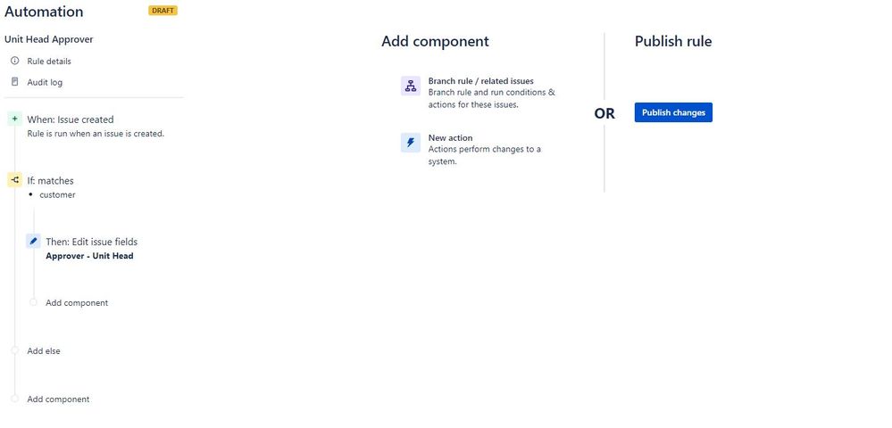

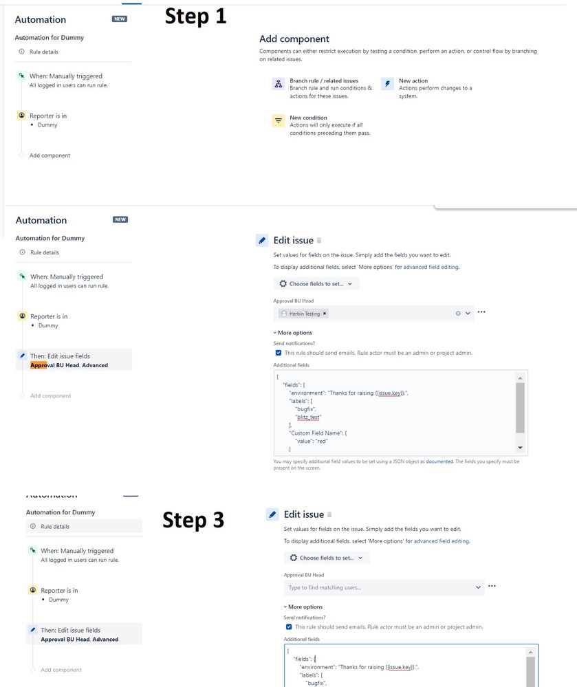

Hi Dirk
Thanks for the reply... My apology for constantly getting your tips and advise (I am new to JIRA).
I tried the solution you have provided, details as follow
Organization = Dummy (containing 3 dummy test customers)
Edit Issue field = Approval for "dummy's" Business Unit Manager. His name is "Herbin Testing"
Step 3... Now I am stuck.
Please refer to the screen cap attached to this.
Thanks again for being helpful.
And now stuck in step 3.
that's what we're here for :)
So in step 3 you don't need to use the "more options", if you open that be sure to remove everything there.
You'll have to make step 3 hardcoded now and on the part where it says "type to find matching users" you should find Herbin Testing no?
for each organization you'll have to then create such an If/then

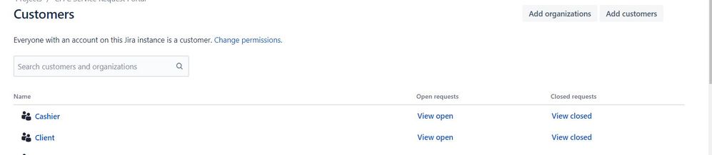

To answer your question, we do not have any form of downloaded app or database to manage customers information.
At most we organize it here (see screen cap)
What I was thinking ...
1. Group customers/users based on organization unit
2. In each org. unit, there will be a "master" approver (say it will be their team lead or a organization manager perhaps). In other words, if a user raise an SR in "Cashier Org", the ticket will be routed to the "master" approver in Cashier.
(lastly the "master" approver will be a hidden field, therefore the info on who is approval will be based on the organization unit the requestor is in)

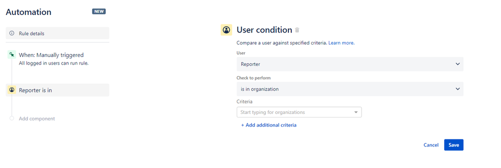

Hey @CHESTER RAMOS ,
I justed looked at the Automation rules and there is a condtion for "reporter/user" is member of oganization "x"
so I guess you could create your organizations in the customers, then create hardcoded rules for each organization and then as the action do a "edit issue" and set the approver to that "master approver"
It will be hardcoded (organization = x then approver = y) but I think this will be the only way to do this without any additional app to automate and store the information
