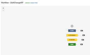

  1. Here is the workflow I copied from a default Workflow:

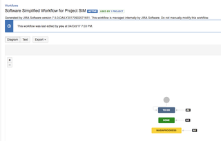

  2. Here is the change from In Progress to WasinProgress:
  3. Here is a completely different workflow where the status has changed:
