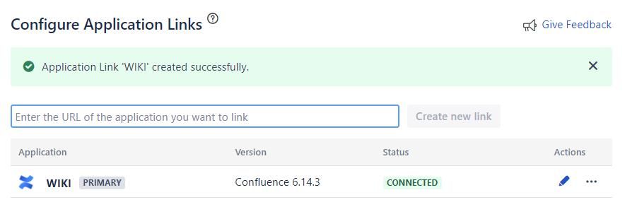

After configuration OAuth (impersonation) Outgoing and Incoming I see Status = CONNECTED

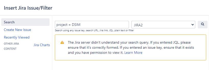

but in confluence page i have:
and can't search any issues:

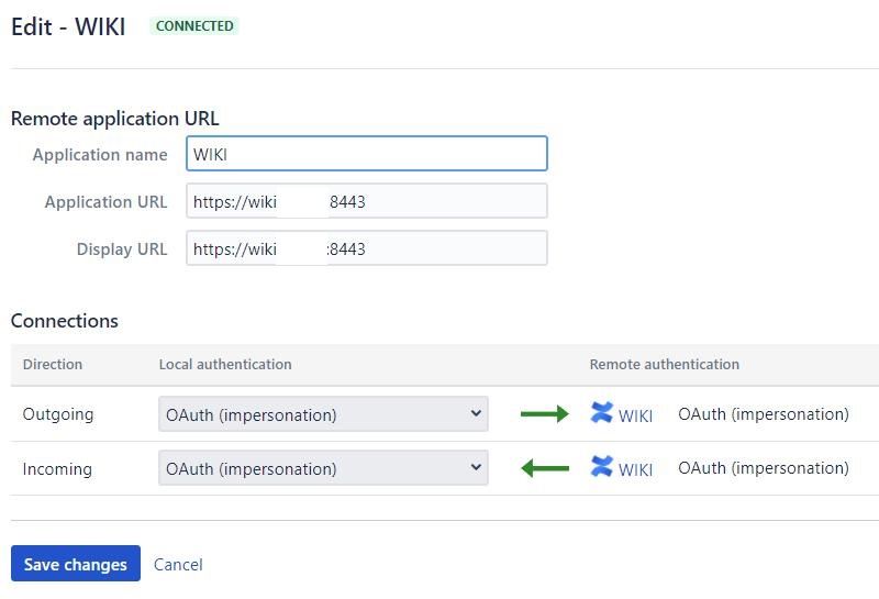

In recreate links page uncheck that i have the same users in jira and confluence. This get me an error  that OAuth not acceptable in Confluence, so I Change it manually to OAuth (impersonation) and it's start working in one directions.

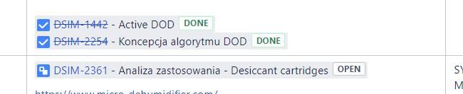

I see issue in confluence:

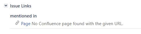

but sill don't see confluence page in jira:
What's wrong ? ;/

I recreate links without any issues:
But still not working.
