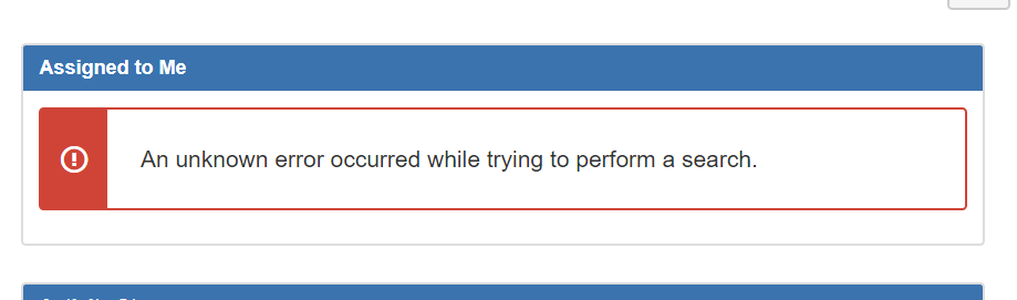

I accidentally wanna change my account name to a better name and afterwards all my jira issues and bitbucket work are gone in the issue dashboard. Then I changed back to my original username. It showed "An unknown error occurred while trying to perform a search".
Can you call me to assist me to solve this problem? I am the administrator of the company jira.

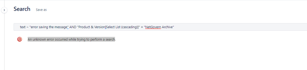

Hi, Shannon,
The extent of the problem is pretty severe. The jira issues are missing from Jira. I tried the reindexing solution this afternoon but it did not recover completely. Now I can see the previous issues. However, if I click "show more". Suddenly all the issues gone, showing the same error I got before.
I think reindexing might help but not solved completely.
SMS
January 24, 2018
Hi Gauss,
I spoke with a few of the members from the Jira Server team, and they let me know that actually this could occur if you changed the name of a user to a username that used to exist for a former user.
Did you change the username itself, or the display name?
You can check the app_users table in Jira for associations of former usernames that could cause this conflict.
To verify, the issues aren't missing for other users, right? My assumption is after the change only your user is not able to view the issues?
Lastly, if you tail the Jira Server Logs when you try to perform the action from the above screenshot, can you let us know what errors are showing there?

      We have a similar error. under System Dashboard all the users see this error - "An unknown error occurred while trying to perform a search" . None of the users are able to access Jira. Any ideas or suggestions why it affected all the users !!!
Thank you for your help.
