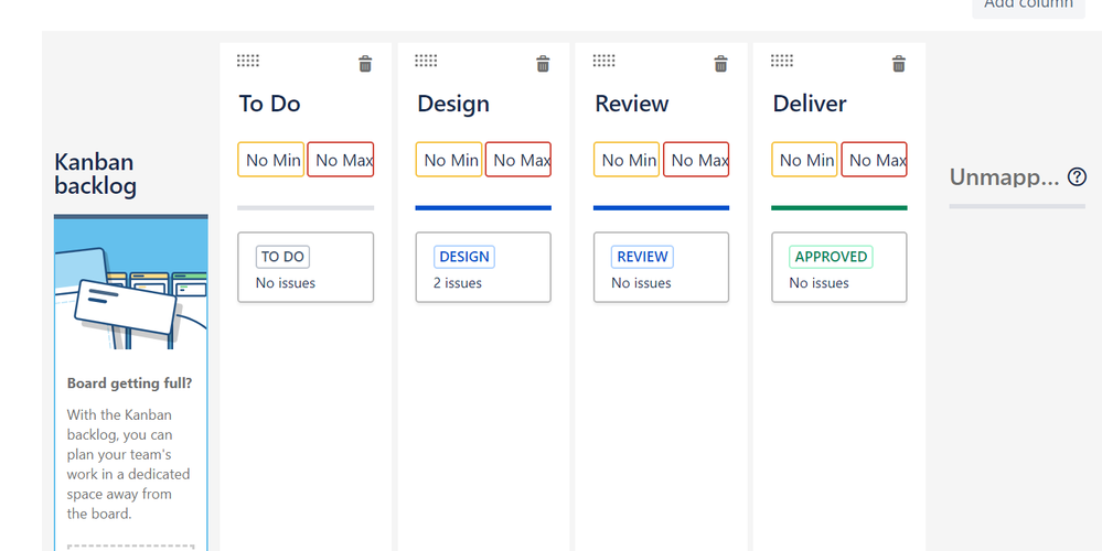

Could you give us the board filter, the "done" filter if the board is a Kanban board, and tell us what status in your workflow are in the "unmapped" column of the board configuration. Then look at one of the new issues that is not appearing on the board?
My Filter Query looks like this: project = ITCNDT ORDER BY Rank ASC
And the query produces the right results as a filter query.
There are no statuses in my unmapped column of the Board Configuration.
So when you create an issue from the board, what project and status does it land in?
Do you have any quick-filters defined?
Hello @Nic Brough -Adaptavist-,
When I create an issue (either from the board or from the left-hand side bar), I get the same error (Issue has been created but is not currently visible). I can find the issues listed when I view "all issues" and in all the other filters in "Issues and Filters". They land in the right status as per my workflow - "To Do". But the issues don't appear on my Kanban board.
I created a Backlog too, mapping my first status "To Do" onto it, but it didn't appear there either.
The only quick filters defined are the default two: "Only My Issues" and "Recently Updated".
Could any settings with my workflow be the probable cause?
No, the workflow won't affect it, unless you've done something in your workflow that is breaking the indexing.
Could you
One other minor thing, which should not be a problem here, but will make reporting look odd - your status are incorrectly categorised. To-do should be in the blue "to do" category, and Design and Review should be in the yellow "in progress" one.
