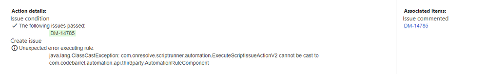

My JIRA version is 8.0.0.
automation plug-in
The condition is that when an issue is commented
If, the manager for me
Then, create a subtask
But the result is a failure, and an error is returned
How can I solve this problem
said kouzibry
September 25, 2024
This is an issue I encoutered many times in the past, there is an incompatibility between Automation for Jira and Script Runner.
The only two solutions I found were the following :
  • Disable automation for Jira and migrate all automation rules as Scriptrunner job/listeners
  • Upgrade Jira to a version 8.4.x or newer and remove automation for Jira : It became part of Jira and is no longer required to be installed separately. The version included in Jira is compatible with Script runner
I hope you find this useful, let me know if you have any more questions.
weizichen
September 25, 2024
Thank u for u reply
I will try to upload my jira version to reslove this problem
