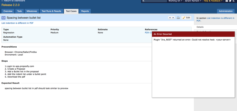

Am hitting this error when I try to Integrate Testrail with Jira
Nishanth Kumar Mohan
August 14, 2018
Plugin "Jira_REST" returned an error: Could not resolve host: <your-server> , Can you please let me know what need to be done from my end to resolve this error.
David Enriquez
August 14, 2018
Hello @Nishanth Kumar Mohan
This error is caused by not using your actual JIRA instance web address in Administration > Integration. The "<your-server>" is the default placeholder and this would just need to be updated to your actual base web address for your JIRA instance. If this is still unclear please feel free to send an email to contact@gurock.com and we can assist you further.
