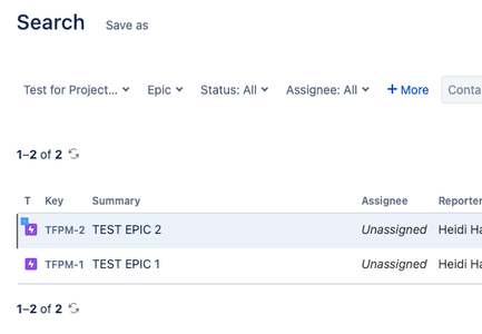

See if you can see the Epic using a filter
Just a simple filter like project = ABC and issuetype = Epic
Heidi Vuojolainen
January 25, 2023
Yes. I'm able to see the issues when filtered.

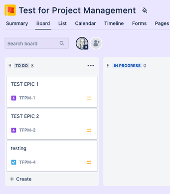

They can be found from the Jira Work Management board:Screenshot 2023-01-26 at 8.12.28.png

Well, that weird. I know this sounds crazy, but have you tried logging out and back in again? Or on another browser? Do other users have the same problem? See if you can be added as an Administrator on the JWM project and then test it.
Just trying to narrow down a few things. And if none of that helps, it's probably going to take a support ticket with Atlassian.
