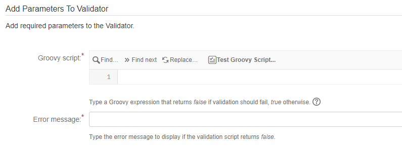

Piper W
May 14, 2023
Hi Alex,
Thanks for you reply.
There is an option named "Scripted (Groovy) Validator (JMWE add-on)" in my transition validator, Is here a right place that  I add your anwser into groovy script?Image 15.png
