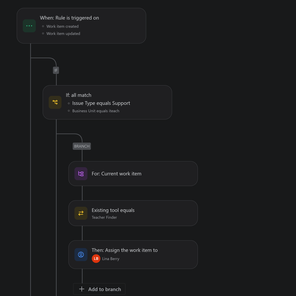

Thanks Bill. Attached is an example of this rule.
Can you help explain how your suggestion would be built?

Ah, your rule is using the generic Work Item Updated trigger...
Let's start with the {{initiator}} smart value is the user who performed the action which triggered a rule.  And, work item assignment is a different event than updating, and so that would use a different rule trigger than an update.
So for the update, you could check the {{initiator}}, or the "User who triggered the event" with a condition to check if they are one of your agents with a User Condition.  I recommend mapping out the logic to decide how to handle the cases, for example:

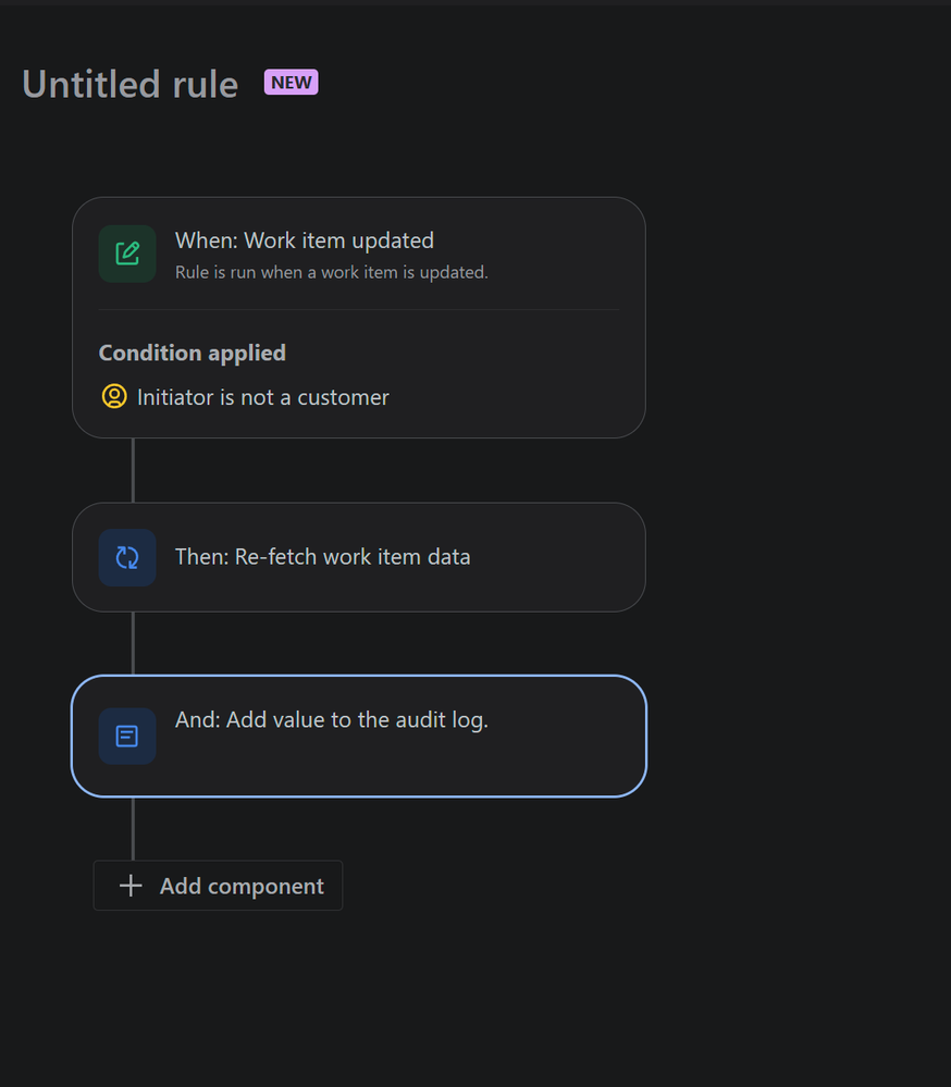

When attempting to build a test rule, I believe I am getting as far as your last suggestion of "write to the log". The only option I see from the Automation screen is to "Log Action" which, to my understanding only writes the action being made to the audit log. Is there another action I should be looking for?
Attached is just a mock up as an example. To make sure I am following what you're suggesting so far and trying to understand this step by step.

That is a good start, and...
I recommend not adding conditions directly to the trigger, and instead add the conditions after the Re-fetch Work Item Data action.  (The new feature to add conditions directly to triggers can have timing problems, causing side-effects.)
For the "Add value to the audit log", this is to confirm the behavior is as expected by writing fields / smart values or just a text message.  It helps diagnose rule problems.  After the rule runs, look at the audit log to observe what happened, and then make rule adjustments.

Ok so, if I am following correctly. I should add an IF statement after the Trigger that checks that the initiator is not a customer. Instead of having it included in the trigger itself. Then follow by keeping the Re-fetch action. And finish with the log action.
Am i on the right track still?
  • Trigger - Work item is updated
  • If - Initiator is not a customer
  • Action - Re-fetch work item data
From here, how would I prevent the ticket from being reassigned back to the original assignee, if my primary rule is set to assign certain fields to certain agents?
