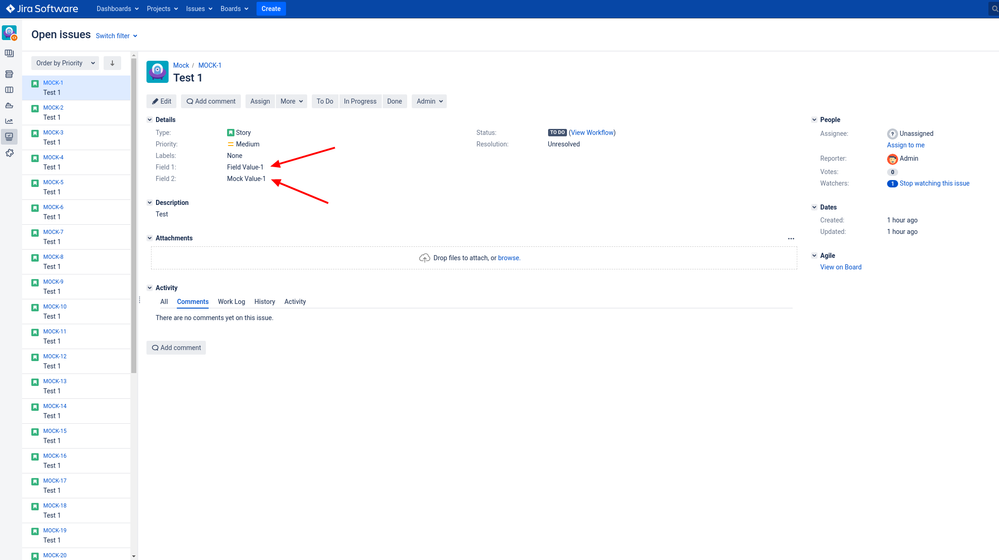

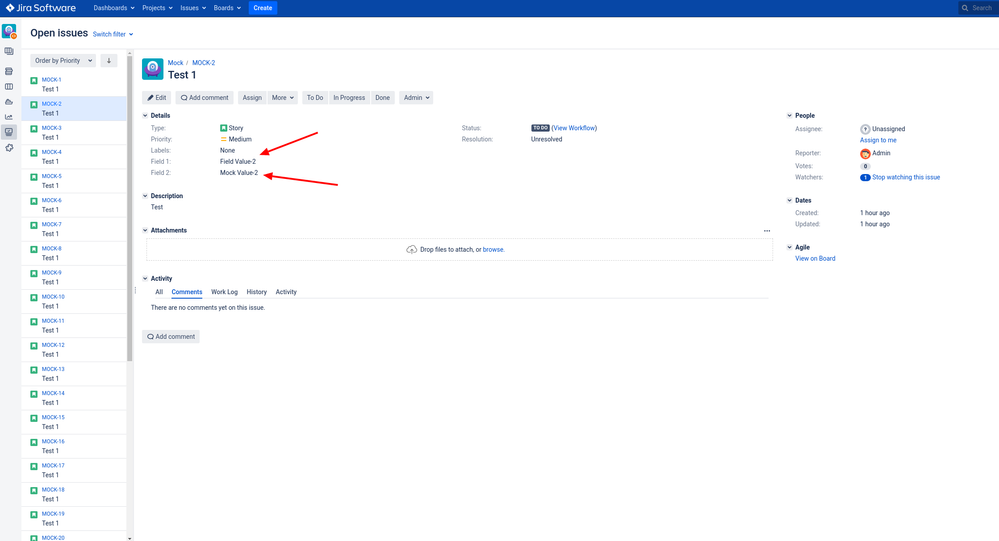

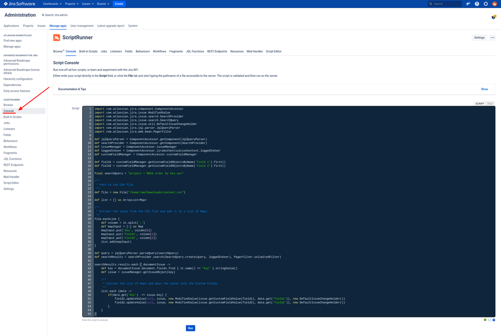

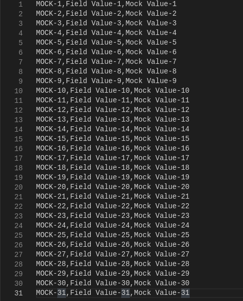

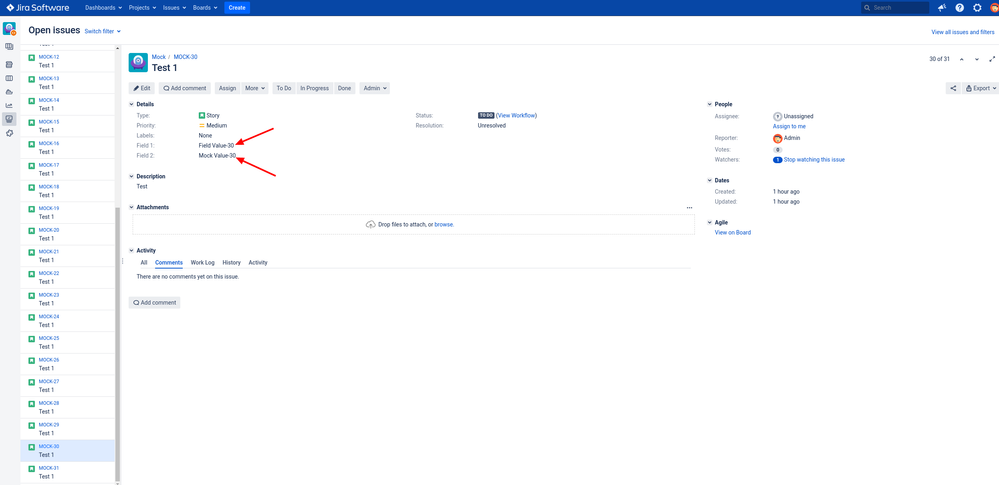

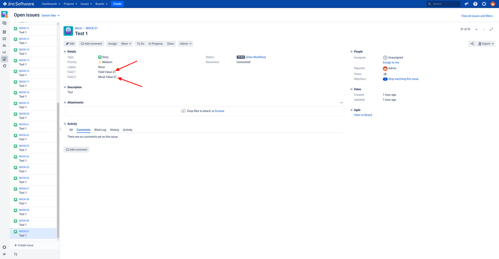

Below is a print screen of the configuration:-
Below is a print screen of the csv values I have tested with:-
Below is a print screen of the tickets with updated field values:-
I hope this helps to answer your question. :)
