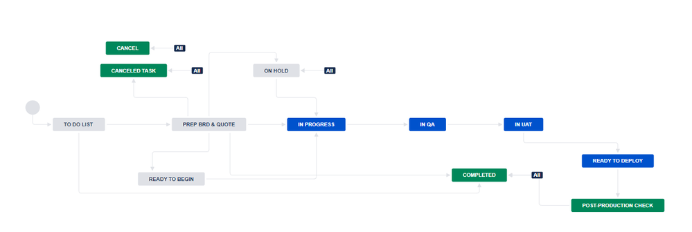

I created the attached workflow, and as you see, I set cancel task, cancel and completed as done tasks, but still I'm seeing all our old completed taskes in the backlog?!!
please could someone advice!!

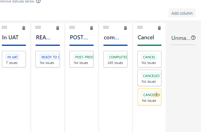

It looks to me like your "completed" status is not "done", because it is not in the last column of the board.  It needs to be in with the three "cancel" like status to be considered "done".  You should be able to go into the column config and drag and drop it into the last column.

Nic we need to separate both completed and cancelled tasks, based on my research there could be multiple statuses that resolve to done.

You are speaking of your board-backlog? - How did you configure your columns in your board? (post a screenshot)
Hana
December 2, 2019
Hello Leonard,
I mapped the tasks to the columns as you can see below. in the capture: Capture12.PNG
