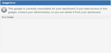

ALL gadgets went missing after a Restore System activity.
Error message as follows:

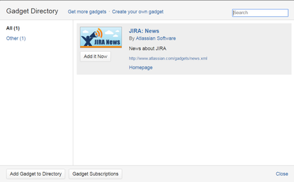

Tried to add gadget but shows only 1 entry:

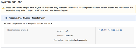

I checked Add-on Manager and still see gadget plugin still there with most of the modules enabled:

I had to pick a few gadgets and disable/re-enable them. No change in the gadgets in the Dashboard view. No changes in the add gadgets window either.
