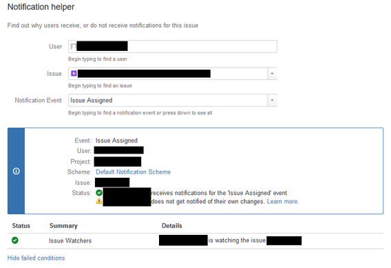

Accrording to your scheme current assignee will not get a notification when an issue was created. I mean if you create an issue and set an assignee for it then only support user wil be notified. Is it the case? Or even if you change the current assignee on an existing issue, the new assignee will not receive an email?

Aslo you can troubleshoot your problems with the following article
https://confluence.atlassian.com/jirakb/mail-and-mail-handlers-troubleshooting-211649643.html

Try to enable outgoing logs and have a look in the logs

Did the user assigned the issue to himself, or was it assigned to him by anyone else?
If it was assigned by himself, that's the expected behaviour, provided that user 'does not get notified of its own changes'. That option can be changed from the user's profile.

Is the affected agent under the Service Desk Agents project role in the project the request belongs to? Note that Service Desk might override some of your configuration in the Notification Scheme.
May the affected agent double check the notification email has not been marked as spam, therefore skipping in the inbox?
