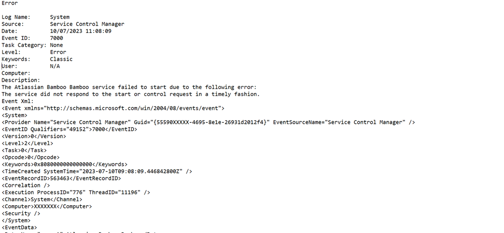

getting below errror message.
Nic Brough -Adaptavist-
July 7, 2023
Start with a look at the system event log - that is likely to contain enough information to tell you what the problem is.
If it says the service started ok, and does not capture the reason it then failed, then look at the Jira application log (<Jira home>/logs/atlassian-Jira.log) and the Tomcat log (<Jira installation>/logs/Catalina.out)
But start with the windows event log.
Snehal Jadhav
July 11, 2023
Snehal Jadhav
July 11, 2023
Getting above error. Please have a look. And Thank you so much in advance .... Waiting for your reply.

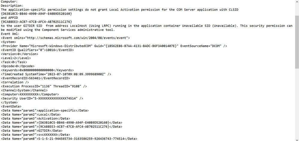

Devendar Gangapuram
July 13, 2023
@Nic Brough -Adaptavist- , could you please assist us on this long time issue.
July 13, 2023
The second bit of log given looks like the problem - the user that you've told Jira to run as does not have the right permissions.
Devendar Gangapuram
July 13, 2023
We will check and let you know @Nic Brough -Adaptavist- . Thank you so much for the quick reply.
