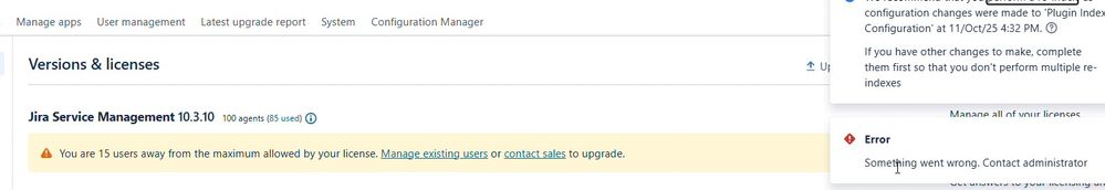

After upgrade from 9x to 10x and installing JSM i got error: Something went wrong, Contact Administr
Aleksandar Salevski
October 17, 2025
After upgrading from 9.12.15 to 10.3.10 and installing JSM i got an error: Something went wrong, Contact Administrator error JSM.jpg

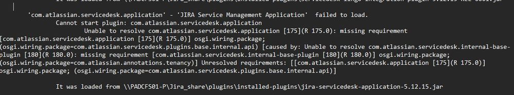

From your log, I can see that
jira-servicedesk-application-5.12.15.jar
That version is from Jira 9.x — it’s not compatible with Jira 10.3.x, hence the “missing requirement / failed to load” message.

this is one of the error i got from the logs,
Caused by: com.microsoft.sqlserver.jdbc.SQLServerException: Cannot alter the table 'AO_8542F1_IFJ_OBJ_HIST' because it is being published for replication.
