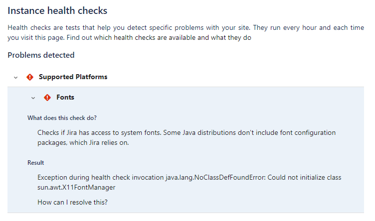

Please see attached for the imaged issue in the Instance health checks.   The layout issue occurs when I went to view the Dashboards and Projects.  Also, we ran Jira Software 8.6, so my thought was to upgrade to Jira Software 8.11 might fix the issue.  After the upgrade, the layout issue seemed to be corrected itself; however, the "X11FontManager" class initialization issue is still persisted.
Thank you and please let me know if you need any other information.
