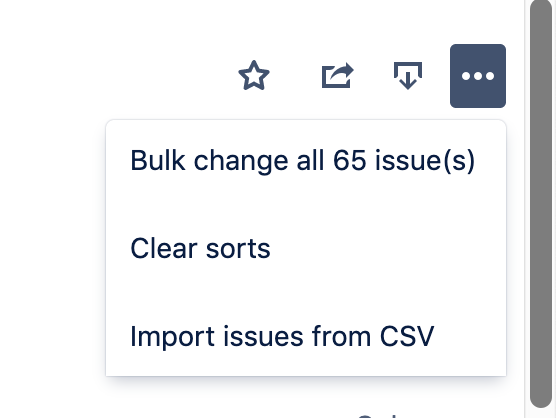

1. I go to advanced search and filter by label
2. I click to bulk change issues
3. Select all issues > Edit Issues > And then scroll down to either "Change Epic Link" or even Change Parent Link (Change parent link as no actionable things to click on just has the text "Choose a parent to assign this issue to."
I don't know what to do at this point. How do I bulk edit parent links?

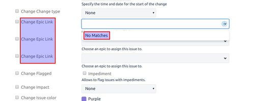

@BG  I am able to reproduce the issue and I believe that either the bug behavior changed due to  some updates or this is a different bug.
Indeed, what I see is the following:
  • If I try to bulk edit the epic link, I get 3 fields to do so (that's already wrong) and, however, none of them is having anything in the drop-down menu but a "no matches":

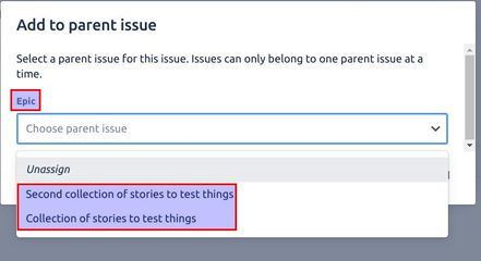

  • If I try to edit one issue at the time then everything works fine:
Please bear with me. I am going to discuss this with our internal teams in order to determine whether this is a new bug or  a change of behavior of the already mentioned one and to see if we can find a workaround.
In the meanwhile, can you confirm you get as well 3 entries for the epic link field in the bulk update screen?
