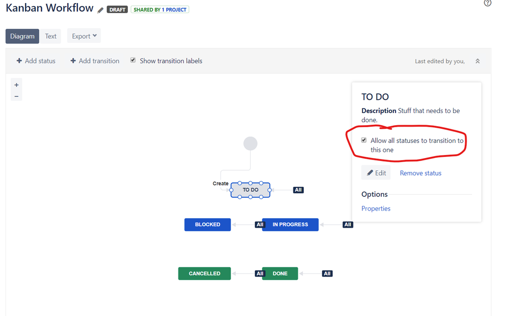

I created a custom workflow for our project after discovering that someone had modified the underlying workflow of our previous workflow and changed a status. However, now I am unable to change the status of the items in our project. How can I fix this?
Justin Vander Ziel May 15, 2019
This wasn't a permissions nor conditions nor validations issue at all; this is simply a matter of not understanding the workflow transitions.
It seems that all statuses in a workflow must either have a defined transition from one status to the other or they must have the property "Allow all statuses to transition to this one" set to true (it should be checked).
In my case, I wanted to allow all statuses to be able to transition to any other status within the workflow. However, I failed to see the little checkbox the first time around.

I did solve the problem I had at the time when I had Jira Admin privileges. If you have Admin privileges and you are able to modify the workflow then the following might work for you:
