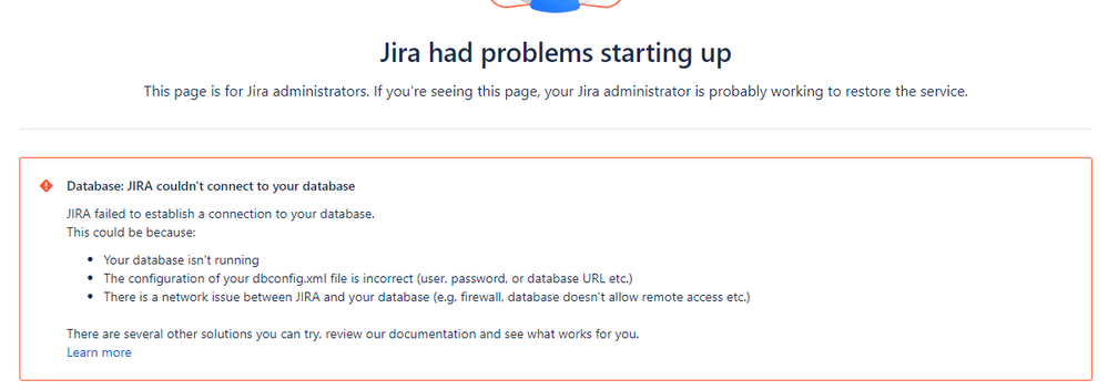

And with
Ip-Address:8443
Error:
If I write extra https://mycompany.bla:8443 or https:// IP-Address:8443
the error is the same with database as above.

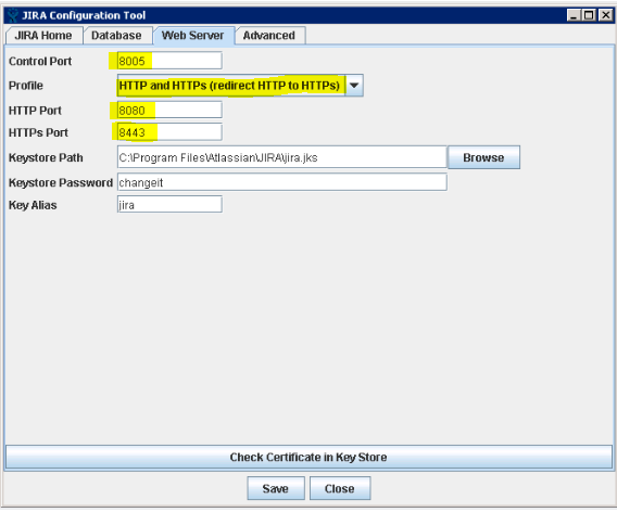

I took the same values for my jira certificate. as under in picture
Maybe this picture is helpful for you

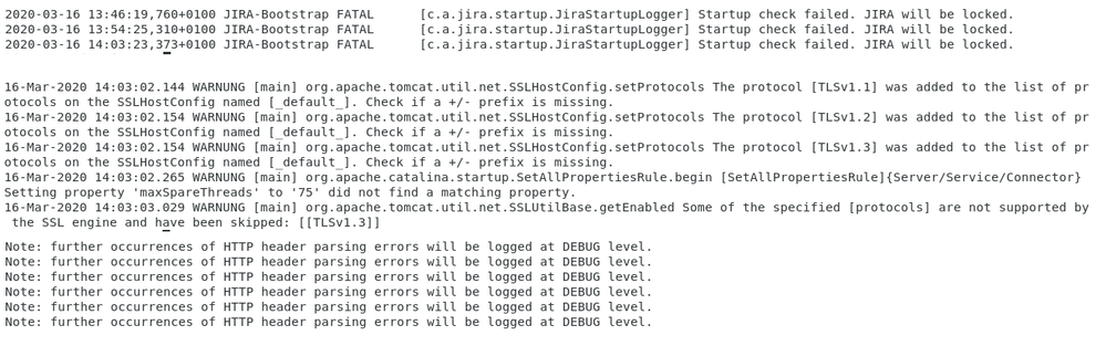

In my catalina.out file are following errors.
