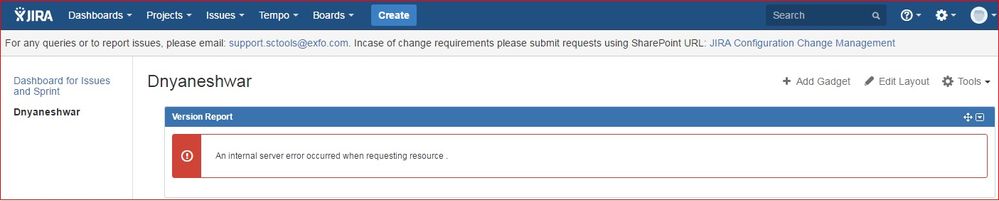

After Implementation of SSL on JIRA version 7.0.10 we got Error "An internal server error occurred when requesting resource" while adding Version report Gadget on the dashboard

I suspect the system can't talk to itself over REST because of something not right in the SSL configuration, but if that's the case, I would expect other errors as well as this one.
You should read the log file to find out what the internal error is.

Please find below error details of the log file for your reference & let me know the root cause of this error.
2017-04-18 05:38:44,715 http-bio-443-exec-10 ERROR [renderer.internal.http.HttpClientFetcher] Unable to retrieve response
javax.net.ssl.SSLHandshakeException: java.security.cert.CertificateException: No X509TrustManager implementation available
