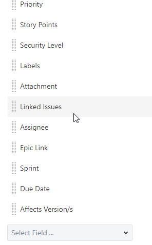

I have assigned  Affect version/s to the project's screen schemes. (default and Bug) (check screenshot)

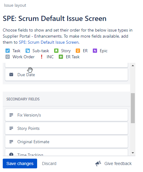

In addition, when I am checking out, issue layout, I can see Affect version/s. (check screenshot). I have also associated affect versions to my project's screens from view field configuration.

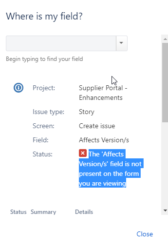

2019-03-04 11_52_25-Configure Screen - JIRA.png2019-03-04 11_53_14-Issue layout - JIRA.png2019-03-04 11_53_24-Where is my field_ - JIRA.pngwhen I am trying to create an Issue, I can't find the affect version/s. When I look for the Affect version/s using Where is my field, it gives below error:
                     "The 'Affects Version/s' field is not present on the form you are viewing"

I would check the following steps on a classic project:
1 - Navigate to the project > Project Settings > Screens > Double check if you have configured the create issue screen with the Affects version/s in the relevant issue types
2 - Navigate to the project > Project Settings > Fields > Actions > Edit fields > Check if the field is properly added to the field configuration scheme of the project and check in the Actions column if the field is not Hidden
3 - Navigate to your project board and check if you have properly configured a valid version in your project
For a Next-gen project, please make sure you have turned-on the Releases feature and Double check if you have configured the create issue screen with the Affects version/s in the relevant issue types

I had to add it to the schema. thank you for the reply.
