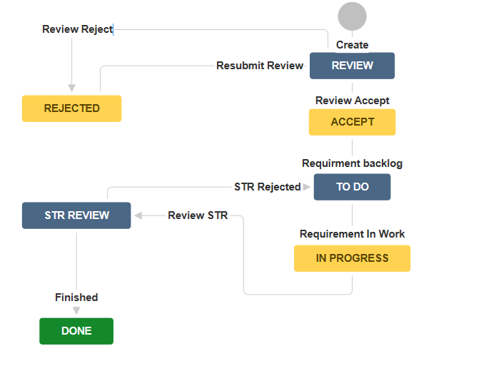

Ideally I wanted to manage the distillation of the lower requirements down to the STR level ( Statement of Technical  Requirement) in a set of sprints and then have a review process to then add these to the backlog for the implementation sprints. So far I have managed to get a work flow to work for the approval of requirements. but effectively if I keep it all in one project I need two in sprint loops (TODO, IN PROCESS, DONE) one for requirement work and the other for the actual development work. Here is the workflow

Now, I clearly understand from your workflow what you are trying to implement. I have implemented something similar at my current place of work, thus I will suggest you not to go for 2 sprint loops but you are on the right track.
Basically, for the Refinement process (done by BAs/POs) created a Kanban board and once the issue moves to the right most column of the kanban board (done) then it should appear automatically on the scrum board backlog. For this you have to map your statuses in such a manner that first 3 should be on kanabn board and 3 to last status on the scrum board. It's important that you have Kanban board for POs so that you don't timebox their work. Because it's the Scrum team which is actually delivering the end value whereas the work/refinement for the POs should flow seamlessly instead of being time-boxed.
