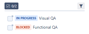

If you are opened to using marketplace apps, I can possibly propose another approach. In order to be completely transparent, we are the maker of the Checklist for Jira server app.
You could alternatively, combine the visual qa and functional qa status together under the qa status. You then use a the checklist app and have it automatically populated with the items Visual qa and Functional qa. Each item can have their individual statuses (in progress, blocked, etc), something like:
This way, you can have both activities in parallel. You can even add a Checklist Workflow Validator to ensure that the checklist is completed before allowing the issue to move to the UAT status.
The only drawback would be that it will possible to find how much time the issue was in the QA status but not in each Visual QA and Functional QA state.
