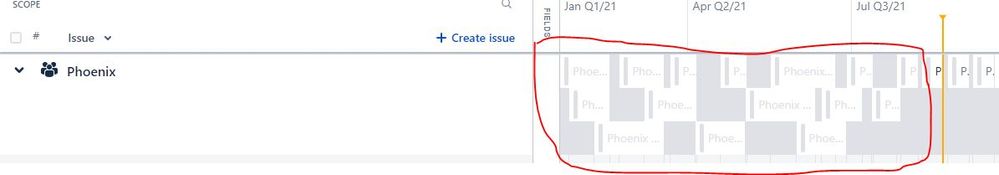

I am trialling Advanced Roadmaps in my JIRA Project and I have a Team setup and linked to the plan.  I have also setup the view to group by team and show the capacity.
When viewing the plan, it is stacking up all our old sprints from before.  and in the past our story management was not very good and some stories spanned multiple sprints and this messes up the view, with a large part of the page showing this.
how can I get the plan to only start at a certain sprint or certain date so that we can concentrate on the future and not have the old stuff cluttering the view?

Hi @Chris Deutschmann
If you're looking to configure the plan so that you start from a certain date, click the "Custom" date button beside the 3M, 1Y, Fit buttons and adjust the range so you can start from a certain date.
Another thing you can do, though it's more work and depends on the fields you already have existing, can filter out completed sprints / work if you're using a "status" field. Status can show whether or not something is "in progress" or "done" and if it's "done", it'll be removed from the view.
Hope this helps.

Thanks Jacob - that helped
