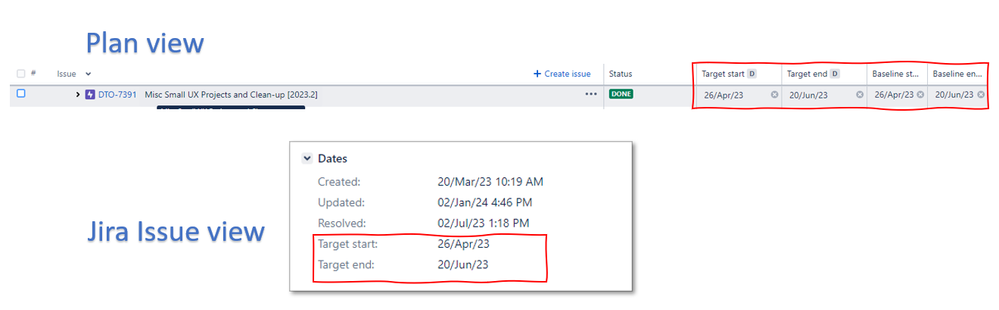

How can I update Baseline Dates using my Automation Rule if Target Dates are dynamically rolling up in Advanced Roadmaps (aka Plans) and not populating specifically on a Jira Issue?
So I solved how to match Baseline Dates to Target Dates.
Solved: How to set Baseline Dates to match Target Dates (atlassian.com)
However, the Target Dates must be populated / visible on a Jira issue for this to work.

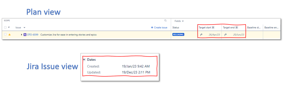

When using Advanced Roadmaps (Plans), the Target Dates roll up dynamically based on the Story dates and are not visible on a Jira Issue.
We want to keep the Target Dates rolling up, but also want to be able to manually trigger our Automation Rule to populate Baseline Dates.

The Target Date fields are available when populated manually. If you are using the rollups, and the data is not manually updated, then they do not appear. I did verify and used 2 different Epics to test it.
"customfield_10104": "Target end"
"customfield_10103": "Target start"
I just have a feeling that because they are dynamically calculated, I won't be able to reference those fields in my automation rule.

I did. I am using Target Dates in other places and it's working. The Target Dates are not on the page if not manually populated.
