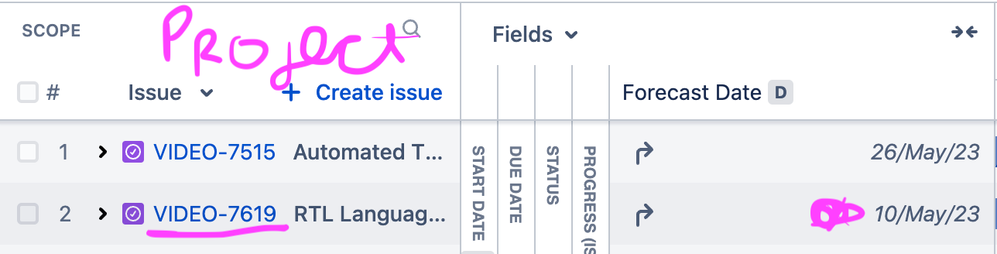

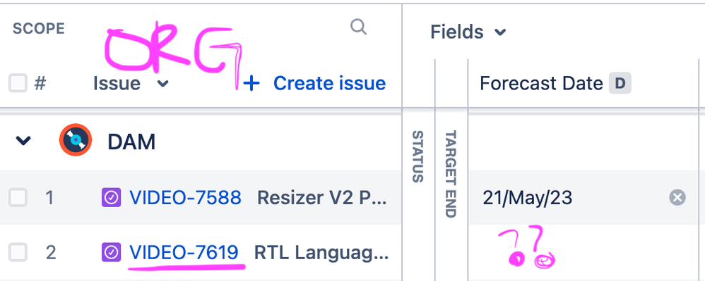

On a project level, the roll up dates are correctly showing. I created a view of all initiatives across all projects and the roll up dates are not updating there.
What can I do? (Two examples attached)
Project = shows accurate rolled up dates
ORG= Roadmap I created cross org that is not showing rolled up datesfp.pngScreenshot 2023-05-03 at 12.54.27 PM.png

Hi @Afrothiti Manolis,
As you can see in your first screenshot, the rolled up date you see there is displayed in italic. That means it is a calculated value you see on screen. It is not persisted in the Jira database and it is calculated dynamically based on the child issues you (don't) see listed under the > levels of the parent.
In your second screenshot, those child issues are not included in your selection. And so the tool does not have any data available to roll up into the parent level. That's why the date is not showing in your second example.

HI! Thanks for the response! I actually figured it out. Since the roll up dates are using the team's scrum board, I had to add that as an issue source.
