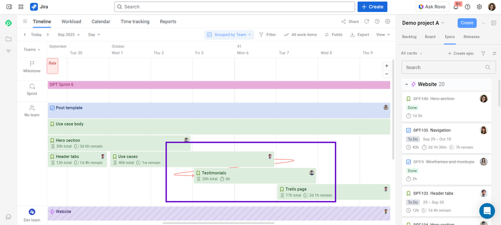

Hi @Sruthi Vijayakumar
In Planyway for Jira dependencies are colored red in case of the risk. Here is how it looks like:

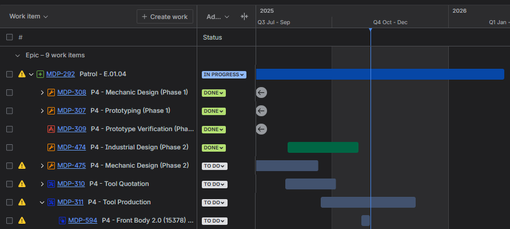

Yes — while Advanced Roadmaps doesn’t currently support turning the timeline bar red, there is a built-in risk indicator.
When a child issue’s date exceeds its parent (Epic/Initiative) end date or when dependency timing conflicts occur, you’ll see a yellow warning icon (⚠️) next to the affected item. This serves as a visual signal for schedule or dependency risk within the plan.

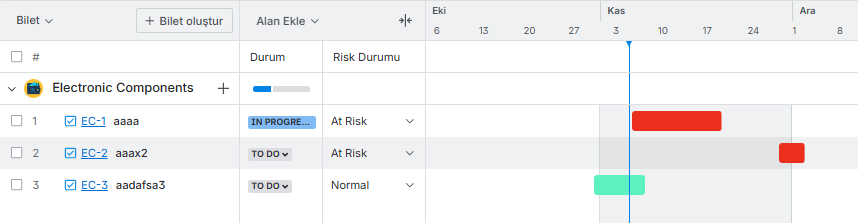

By default, Roadmaps doesn’t dynamically recolor timeline bars (like red/yellow/green based on conditions), but you can simulate this using a supported custom field and the Color by field option.
Created a Single Select field called “Risk Status” with values like:
 • Normal
 • At Risk
Plan view → View settings → Colors → Field → Risk Status,
I mapped:
 • At Risk → 🔴 red
 • Normal → 🟩 green
This way, even though the bars don’t change color natively, they appear red when “At Risk” is selected — which gives the same effect visually.
Here’s how it looks after applying this setup 👇
This approach works perfectly because the Color by field feature only supports certain field types — like Single Select, Status, or Priority — not text or checkbox fields.
So as long as “Risk Status” is a Single Select field, you’ll see the colors just like this.
