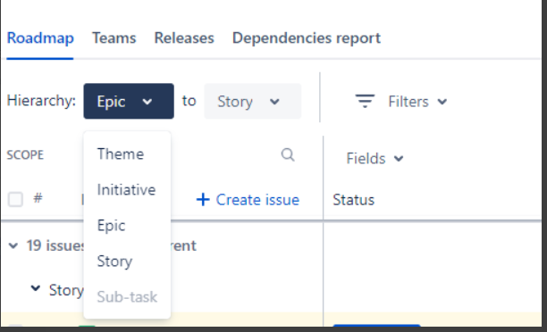

Issue type "Milestone" is not showing in Advanced Roadmap Hierarchy drop down list. I have read multiple documents that show how to get this done but obviously I am missing something. It also does not show in in the dependency report roll-up drop down list.

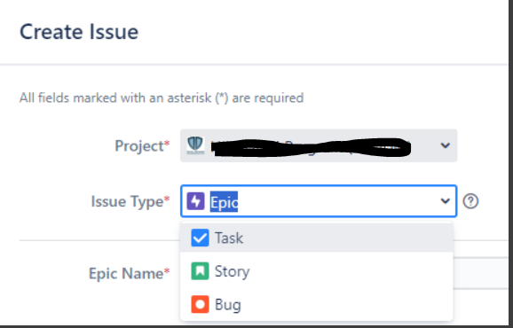

Can you show us the Issue Type Scheme information for this project from Project Settings so that we can see that Milestone is included?

Can you show us the Issue Type Hierarchy configuration page and point out at what level the Milestone issue type has been added?
https://YourBaseUrl/secure/PortfolioHierarchy.jspa
Concerning the absence in the Advanced Roadmaps Hierarchy list, I believe that shows only the Level Names, not all the individual issues types. If the Milestone issue type is on the same level as other issue types, it would not be called out there by name.
Thank you. That confirms that Milestone is a hierarchy level and issue type.

No, thank you for all your help so far. So far Milestone shows as it should everywhere. Not sure why I am not able to get it to show the Milestone to Epic hierarchy correctly with collapse/Expand functionality, like we can with the other existing Jira Issue types.
