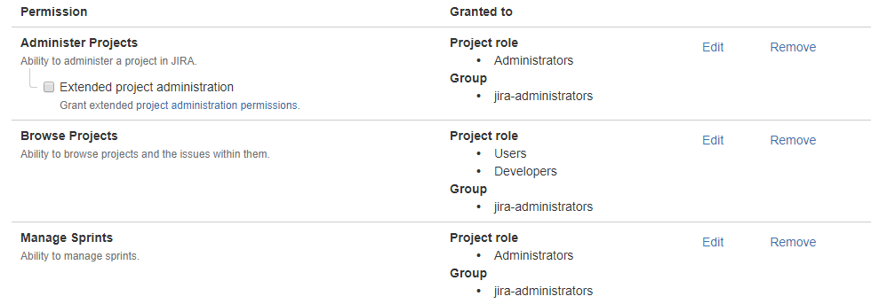

A simple thing to check, look to see that project role Administrators, the group they are in, or the individual has Browse Project permissions for that project.
Best for it to be the project role, it makes the project permissions dynamic and easier to maintain, but it's possible to add groups or individuals.
You may also need to check the Permissions scheme for the project; if the user is not included as part of a group or as an individual user in the permission scheme used by the project that user won't have access.

Here is what I mean by using Project Roles and Groups in your Permission Schemes. The only Group we use in our Default permission scheme, which we use for 60+ projects in a 110 project environment, is jira-administrators, and that's mostly just a visual separation for us. We could totally assign jira-administrators to the Project Role Administrators. and not have any groups at all in the permission scheme.
We only use a few project roles
Admins - can admin the project, including adding users to the Project
Developers - do all the work, can Browse, Edit issue, Transition issues, etc
Users- is treated as view only. Most projects allow anyone in Jira to view the items in the project.
All of the actual user management is done within the Project itself, using the project roles. You can do that as group based or individual based as needed. If you assign groups to the roles, you can do all of your user management centrally, when you add a user to the system. They will inherit the rights to the project that the group is assigned to.
Downside is that only jira-admins (not project admins) will be able to manage the groups a person is assigned to. I you need for the project admins to be able to do the assigning to project roles, then they can be added as individuals directly to the project roles.
Everyone in our environment is added to jira-users by default when their account is created, this give the the view access into the 60+ projects with the Default Permission Scheme. Nothing else needs to be done for them to have that access.
