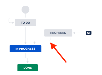

Here is a simple example workflow diagram.
When you see a Global transition like the one pointed to by the red arrow that means an issue in ANY valid workflow status can be changed to the status pointed to by All.
From Status >> To Status
All (Any) >> In Progress
The Global transition indicates which statuses the issue can be in currently and then be changed to the destination status pointed at by the transition.
If you have a Reopen status in your workflow and Global transitions to other statuses in your workflow, then an issue in the Reopen status can be transitions to any status pointed to by a Global transition. In the workflow above, if I added a Reopen status, issues in the Reopen status could be transitioned to To Do, In Progress, or Done.

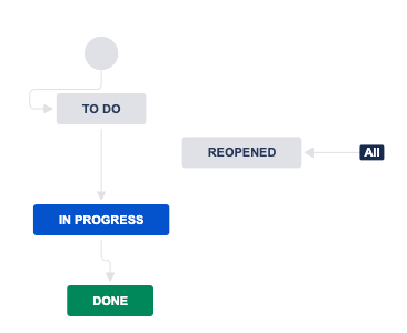

Here is another example workflow. In this case there are no Global transitions.
In this case the transitions indicate limited options:
To Do >> In Progress
In Progress >> Done
If I added a Reopen status to this workflow with a Global transition to it, that would allow issues in any status to change to Reopen, but not allow an issue that is currently in Reopen to change to anything else.
If I want to allow an issue in the Reopened status to change to the In Progress status, I would have to add a transition between those two statuses.
