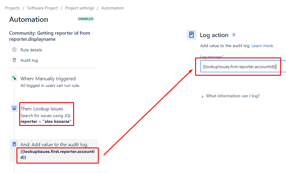

Yes, there is a way. Kindly see the next screenshot (and replace "alex koxaras" with your value from {{issue.description.substringBetween("<customer>","</customer>")}}:
But here's the catch: When you lookup the issues using only the reporter's name, you have to add another field as well, to narrow down your results. In the example above, my lookupissue component yielded 139 results. So the rule only for logging the output was 7 seconds!!

Thanks a lot for your great answer. it worked.
Had other issues as displayname was not like Jira wants, but created a comment to transform text and delete it at the end of the process. Like this no need to create a custom field... but of course resource consuming.
I will check and see how it evolve with more and more data.

Just a small reply that I made the same but with lookupobject as I can find information in insight to get back to my issue
Still need to survey performance but look ok for the moment as it's during creation of an issue
