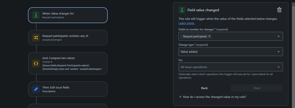

Hi @Bill Sheboy Yes, all of the rules have the same trigger. Value Added, All issue operations. Each one will trigger if that 1 "team" is added as a participant. So 6 different teams have their own rule. The problem is that if 2 teams are added at the same time, only the first team's rule will run.
The other 5 don't run at all. Like they don't realize that multiple values were added. Does that make sense?

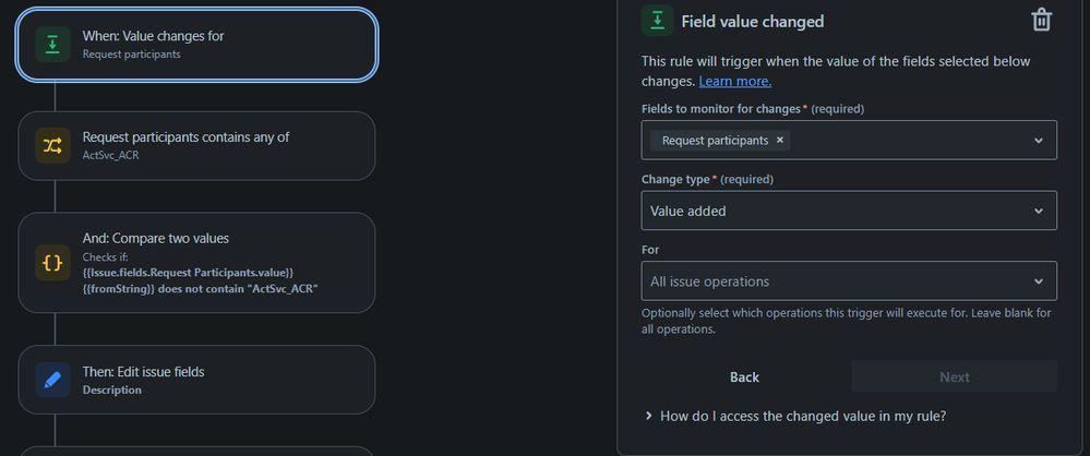

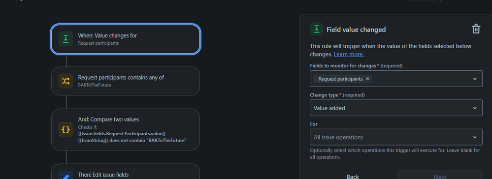

Please post images showing the triggers from at least two of the rules to confirm they have the exact same settings.

Thanks for those images of the rule triggers.  When I tried this scenario, it worked for me in a JSM project, with multiple rules triggering and only the matching one passing conditions to proceed.
