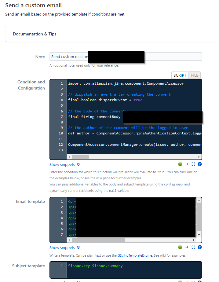

I am using a scriptrunner and their build in scripts. Under Workflows I have made a Post Function using their build in "Send a custom email".
I have made the email in HTML and added the $issue.key $issue.summary to the Subject - So that JEHM will se the email if the client responds to the email.
I works very well, byt i want to ad som flair.
The Client email is in a custom field, and i want the email to say:
Dear Customername
I have used:
${issue.fields.customfield_XXXXX}
but it does not work? Also how do i remove the @email.com from the custom filed?
Do I need something in the "Condition and Configuration"

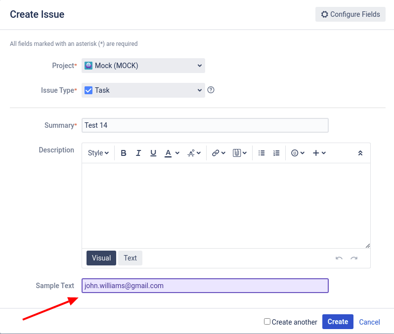

1. When the issue is created, the sample email john.williams@gmail.com is added to the Text Field

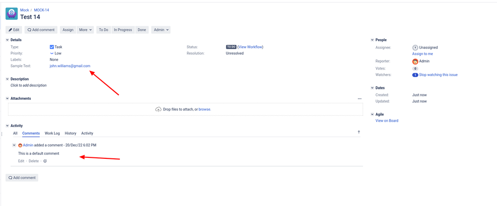

2. When the issue is created, the Sample Text field is displayed and a sample comment is added

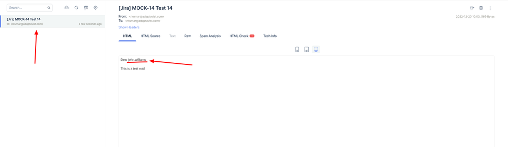

3. Finally, when the email is sent out, the email address is truncated starting from the @ symbol only displaying the recepient's name.
